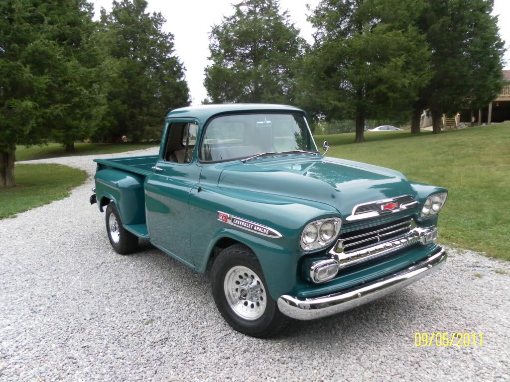

durwoods59, That's a great lookin' truck!
Ditto on that Dave, love the twin headlight TFs!

Thanks guys! It's been 3 years for a frame-off. Back to original except added power brakes, new wheels, more chrome and polished SS bolts, bed strips, and LED taillights.
Lots more pics on photobucket link.
http://s171.photobucket.com/albums/u320/durwoods78/1959%20Chevy%20Apache%203600/

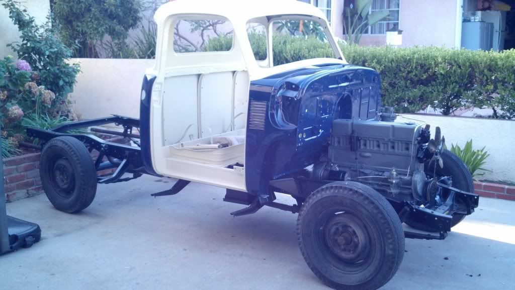

Yesterday I finally finished the long sanding process on my cab with my wife's help. (Her idea to help!!) Yea!!! Today will be seal primer day & color by the weekend. I may just get the cab back on the frame in the next few weeks. You never know, I may even make my self imposed deadline of next May for completion? Thank you all for your posts of your projects which have inspired me to finally get the 37 back on track after a time of loss of interest & frustration!

You better take her out to dinner real soon.

Big Chevy 3600, thanks for the reply. My truck is pretty much stock. I'm not adding air, new steering column, etc. Just keeping it like it was before I took it apart, only hopefully better. Good thing is I ordered many of the needed parts over the past few years. I know I will need more & anticipate delays. I should have been more clear about "my self imposed deadline." I should have stated, "drivable, not finished." I have a friend coming from England in May who wants to drive it. That's my goal. It doesn't have to be totally complete, just driveable at that time. I don't think our trucks are ever completely finished, are they? I know my MG TD isn't even though I can drive it any time I feel like.
FriedGreenTmater, I will take her out for a nice dinner soon!!

Got the frame and wheels back from the powdercoaters today. They look awesome!
Posts: 4,983
Posts: 4,983
Yeah, where are the pics? pix
~Jim
Posts: 19
Posts: 19
after work...I installed the alternator and new heater valve, then painted the radiator and bolts. Also cleaned and painted the blow-by tube and oil bath air cleaner. Next step, gas tank, radiator and radiator support (powder coated black). I agree with Baba, powder coating looks awesome.
Where she started... In the Jungle
How she looks today... Re-hab
Last edited by Tim in California, 55.1 Bolt; 09/21/2011 6:03 AM. Reason: added hyper links
