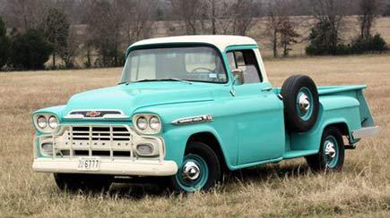

For my Christmas present, my sweetheart sent a photo of my old truck to an artist in Europe who painted a watercolor rendering of it. The picture is called "Old Blue Truck" ... best Christmas present ever! What encouragement my wife has been through all of this. I'm one lucky man!

My goal to get the truck on the road in 2014 was met! Since its original trailer-home day in 2009, it came with a lot of work, learning and experiences. It seems we covered it all, from engine and tranny and brake rebuild to seat rebuild and upholstery, heater rebuild and restoration, body repair and final paint.
I wire brushed and painted almost everything I took off the truck from the beginning, so it would look like new when I re-installed it. I think that was the bulk of my work! I had my hands in all of it. What a feeling of accomplishment!
The truck already made its debut in a photo shoot and I love the waves and thumbs-up as we introduce it to the community by taking short drives! What amazes me also is on the Facebook Page I made for the restoration journey. I continually get likes from all over the world. I'm in hopes that my experiences can encourage and even help other enthusiasts like me.
