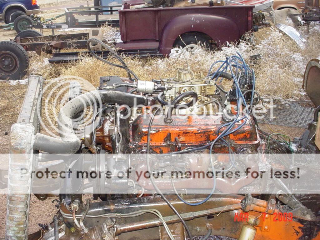

I found a guy who made regular runs to the scrap yard and he removed the suburban body, leaving me the frame drivetrain and steering column for free to me. We are still friends so he must have made out OK on the scrap prices. I parked the frame beside the '53 bed and frame and started taking measurements and scheming a plan.
Every night when I came home, I would have to navigate around these two frames to get into the garage. So I thought about the project daily. The biggest obstacle I could see was the way the '73 frame had the raised areas over the axles. I kept trying to figure out what I would have to cut out to make it all work and what structural damage would I do by doing so.
Then one day I suddenly realized that I was looking at the wrong approach. I came up with the idea of hacking the '53 frame and putting it on top of the '73 frame, instant 7 inch lift kit without making dangerous alterations to the suspension. Some might say "now you are top-heavy and dangerous anyway", but that is not the case. In the end, the added weight of the frame actually lowered the center of gravity making the old truck more stable than the original Suburban.
