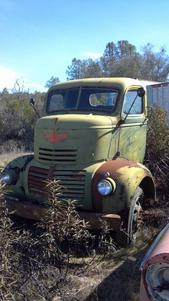

Just picked up my 40 coe. She's about 98% complete and I'm trying to get her runnin. I think she's a 6v, positive ground system, but am unsure as I don't have a manual or a wiring diagram? I'd like to know where I can get parts,and info.

Threw in some fresh gas,new coil,cap,rotor,condenser and plugs. Disconected the wiring harness and hotwired her. A little shot of starter fluid to help out,,,,, and she fired right up!!! Purrs like a kitten! I'm super stoked!
So I drove her around the block a few times taking turns with the wife and kids as passengers and I have a couple of questions. Shes very low geared probably tops out at 55? We got her up to 45ish didn't seem like there was a lot left? She has so much torque that I had to drive her with the throttle knob, is that normal, or do I just need to practice? Definatly need to work on the down shifting. I'll work on linking some pics tomorrow. We think we're gonna call her "Miss.Betty"

After using a link posted by another member I was able to figure out that it is a 1941,GMC,350series,with a wheelbase of 176 7/8". Now to clean off the motor plate for the engine numbers.
Edit.
The motor is a 235. It looks like the wheelbase has been shortened by about 4', and I cut off about another 2 1/2' of frame behind the rearend that was pretty beat up.
I linked some pictures in the first post. If you click on the alblum,"Miss.Betty" there are a few more.

Had some time to get the numbers,some of them were hard to read but here they are.
Drivers side on the firewall, I58I-3290
The original ID plate states,
General Motors Truck
Manafactured By
Yellow Truck&Coach Mfg. Co.
Pontiac,Mich.USA
Mdl.CF354 Sn.536
87hp@3000rpm Max Gross,15,500
There's another plate on both sides of the cab. I'm guessing the company that outfitted it for the military? It states,
Doane Motor Truck Co.
San Francisco, Ca.
No.AB153 Cap. 4/6 Tons
The engine number looks like D23605471. Looks like XS37 on the rearend. On the door in faded Yellow paint is,
USMC
50684
DQSF
I think thats just about all the pertinant info? I'd be interested in any help in correctly identifying my truck. Engine size,gear ratio,year all that. What it was used for in the military would be cool to know as well.

C=1941
F=COE
354=350 Series, 4=176 7/8" wheelbase
SN= 536th off the line for 350 series trucks
The 236 in the engine serial number indicates a 236 engine, although originally it could have came equipped with either the 228 or 236.
Is the rear a single speed or two speed?
The thumb lever on the shifter is the reverse lockout switch so you don't accidentally pop the truck into reverse. A huck brake rear would have had the ebrake connected through the backing plates not a driveline brake.

That makes sense, I think the tranny has been replaced, hense the modified e-brake. I think they did that when the PO put on a brake booster, it took the area where the e-brakes used to be routed.
As far as the rear end? Doesn't look like a two speed, but there is some sort of adjuster on the side of the pinion?
She fires up on her own now! Thanks to some starting advice, and just knocking the cobwebs out. The more she gets used the better she's working, and the better I get at shifting.
