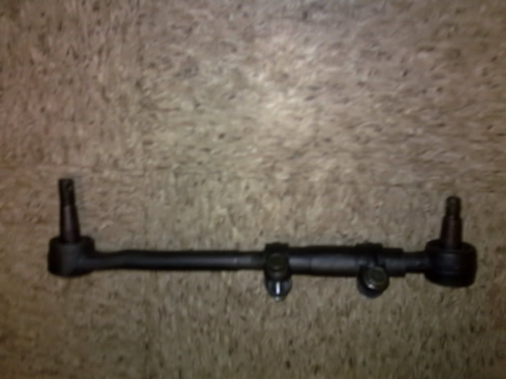

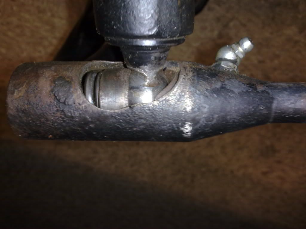

| | | | | Joined: Mar 2005 Posts: 1,513 'Bolter | | 'Bolter Joined: Mar 2005 Posts: 1,513 | There is a method in the tech tips I have been following and have so far taken it apart and acquired the 3 parts: http://www.stovebolt.com/techtips/draglink_adjustable.htmlI could not get the plug out of the drag link on my truck but since it was snug with no play and moved reasonably well I just lubed it and let it go until now and here’s what I found. Now I know the cups can rotate off the relieved portion and gnaw at the ball shank and eventually break it off. Removed view.  The new tie rod ends have a different taper angle on them so I either need 2 tapered tools or a different one that matches. Here’s what I know about the components so far: Napa 269-1118 – sleeve Moog # ES 426 S application: 72-78 Ford LTD Napa 269-2078 outer tie rod end Moog # ES 403 R application: 71-76 Chevrolet Caprice Napa 269-2225 – inner tie rod end Moog #ES 288 L application: 61-68 Dodge D100 More to follow.

| | | | | Joined: Apr 2009 Posts: 554 'Bolter | | 'Bolter Joined: Apr 2009 Posts: 554 | I wanted to update my parts as well and looked at all the options. I planned on installing tapered tie rod ends myself but due to the difficulty in removing the old balls and the cost of tapered reamers I went a different route. I sent my pitman arm and steering arms to Sid's Axle's http://www.droppedaxles.com/. He finished removing the balls, taper drilled the holes, supplied the tie rod and drag link ends, and made new tie rod and drag link tubes for not much more money than it would have cost me do do a lesser job. I am totally pleased with the results and have a totally adjustable drag link that makes centering the steering wheel easy. I have no affiliation with Sid but rate him as one of the best vendors I have dealt with and a superior product. Chuck | | | | | Joined: Jan 1970 Posts: 365 Shop Shark | | Shop Shark Joined: Jan 1970 Posts: 365 | Thank you for all the replies. I am retaining the OEM steering arms and liked the looks of the CCP units.
I alos like the idea of the adjustable drag link as suggested by Curt B., and after perusing the tech tips section, I think I will also use this setup. Before doing so, I will consult my local machinist to make sure he has the tapered reamers needed for this. If not, I will order a complete drag link because mine is completely worn out. | | | | | Joined: Feb 2000 Posts: 5,221 'Bolter | | 'Bolter Joined: Feb 2000 Posts: 5,221 | The ability to adjust the drag link sure made a difference in how my truck drives. It gave me the ability to center the gear box dead on straight ahead. It no longer wonders around since the gear box is adjusted with the proper preload.
