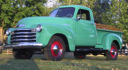

What I learned about tires
My truck has been finished for two years and I thought it might be useful to report on my tire experience.
During the four years I spent restoring the truck, I was usually on the Stovebolt site multiple times a day but somehow life, work, and other projects eroded that to an occasional visit. I still have the greatest appreciation for all the help and knowledge available here.
One of the things I followed closely during the restoration was radial tire choices. There were several favorites whose profile came close to a stock bias ply. At that time, only Coker seemed to offer a radial that really looked like a bias ply but it didn't seem to be a popular choice.
I decided to try them anyway.
Things didn't start out all that well. As I was having them mounted, the tire guy called me into the shop to show me how out of round one of the tires was -- he said it was really bad and to only use it on the rear.
Another one took a whole lot of weight. Two weeks later, I had a flat. Turned out neither I nor the tire shop looked inside that tire where the plastic sticker was placed and it had rubbed a hole in the radial tube. However, that was the last of the bad news.
I have a few thousand trouble free miles on them now and have been very happy. Despite the out of round and balancing issues, the truck goes down the road straight as an arrow and I don't feel any vibration. I don't know how long they will last but they still look new.
When these do wear out, I will likely replace them with the same thing unless there are better options then.

The "fence extension" (truck) had sat there, out in the weather, for 24 years. She finally admitted she would never be able to restore it.  Her only caveat was that I had to keep the truck stock. That was not my first choice then but I kept my promise (basically) and am now really glad I went that route.
I was surprised by the lack of rust on this truck. I knew it had been outside since at least 1974 and had been up on the blocks since 1985. We average 30-40 inches of rain a year here. There was lichen growing on it but no visible rust thru areas (yet). I had seen a lot worse rust problems on newer trucks in this area.
I am not exaggerating at all when I say that without the Stovebolt forum, I don't know if I would have pursued this project. The people who donate so much time and knowledge are just an incredible resource. I have only had the opportunity to meet one fellow Stovebolter but really felt like I was part of a family.
It was bittersweet to slowly wean myself away as I moved on to other things that I needed to spend time learning about. One of the best pieces of advice I saw given several times was to try and do something -- even a little thing -- everyday.  I pretty much adhered to that and that is partly why it took me four years. I worked on it one piece at a time.  When I would start getting burned out on the endless metal work, I would tackle a job like rebuild the steering box or the gauge cluster. There seemed to be endless little projects to keep it interesting.
I had to build racks in my shop to hold the completed parts. By the time I finally finished the body and paint work, every other part of the truck had already been rebuilt or replaced, wrapped up and ready to install. When the day finally came to start assembling everything, it was like Christmas to me every day. Adding finished part after finished part was both very exciting and rewarding.
I was somewhat afraid I would be disappointed when I would finally start driving the truck. I had gone thru a lot of old trucks in my youth and driving them was ... well ... challenging.  What I didn't take into account was in the past, I always had a truck that was pretty clapped out and all I ever did was try and keep them on the road. I never had the opportunity to drive a newer truck back then.
I don't think there is a moving part on my truck that wasn't refurbished or replaced and it drives like a dream.  I am pretty sure it drives better than when it was new thanks to some upgrades.
I used as many 216 parts on the 235 engine as I could.  It's now 12 volt but I run a generator and regulator and the battery isn't visible.
I upgraded the tie rods, added a sway bar and radial tires that really help the handling.  Higher gearing let me run down the road without holding up traffic.  Except for cosmetics, the truck is stock otherwise. The Stovebolt experts would be able to spot some of the upgrades but most people would not.
A final trivia piece: this truck was manufactured in Oakland, California in May of 1952 and has never been out of Northern California.
One benefit of this project that was a great personal benefit to me was a major weight loss. Instead of sitting on the couch, feeding my face and watching TV, I spent a little time each evening and on weekends working on the truck. In the first year I went from 282 pounds down to 220 and have been able to maintain that weight ever since.
