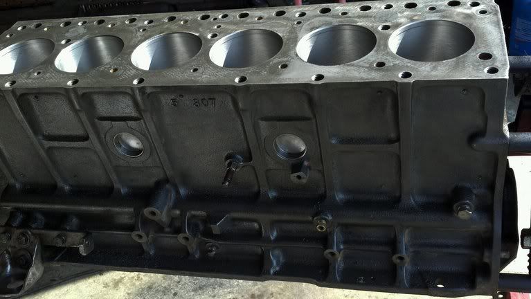

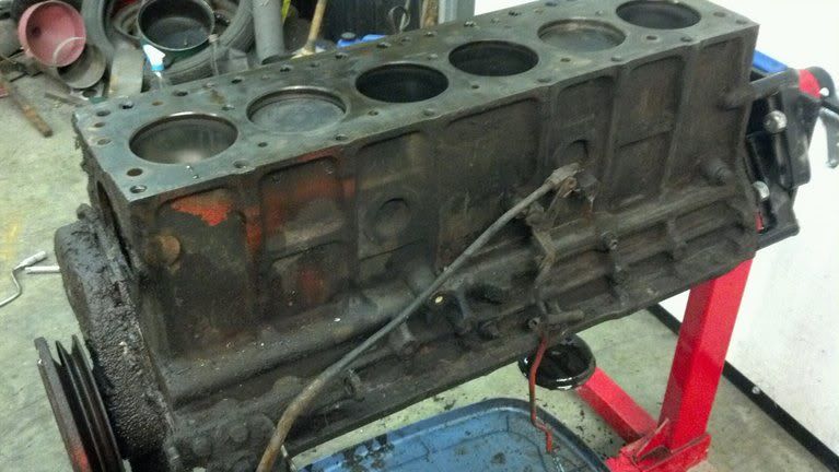

I turned this............
[IMG]http://i236.photobucket.com/albums/...ject/photobucket-11563-1332944466466.jpg[/IMG]
[IMG]http://i236.photobucket.com/albums/...ject/photobucket-18484-1332944551608.jpg[/IMG]
Into this..........
[IMG]http://i236.photobucket.com/albums/...ject/photobucket-18249-1332944526184.jpg[/IMG]
[IMG]http://i236.photobucket.com/albums/...ject/photobucket-12154-1332945003174.jpg[/IMG]
OK, that wasn't "today" it took me all week. Got the head off at the machine shop getting rebuilt. New rings, rod & main bearings go in next week.
