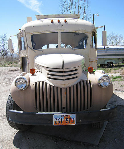

I would like to share the story of my 1946 Chevy 1.5-ton short bus. The image here is "pre-restoration" ... among a BUNCH of things, I plan to re-chrome the bumper!

I found the Wayne body shorty bus on eBay after searching for over a year. I fell in love with the Art Deco front end and lines. I traveled to Utah where, I finally got a look at this darlin' up close and personal. I am very happy to say, it was in better shape than I had hoped for!
Sure, it needed a ton (or perhaps I should say a ton and a half, since that's the chassis it's on) of work, but it seemed to be a great little starter platform.
There was very little rust with only a couple of small replacement patches needed next to the front fenders and one "wrinkle" next to the entry door. The latex house paint was peeling, but that was coming off anyway.
