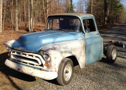

Well, here she is. This is my Stovebolt! And this is his story.

The PO I bought it from purchased it from another PO, who was not the original owner either. That PO lived in Tennessee and he was the one who had disassembled it for restoration. That was about 1998. The PO I bought it from intended to reassemble all the parts too, but he had a recent divorce and needed cash more than another project. Other than a really bad light blue metallic paint job (that looks to have been applied by Tennessee guy with a roller), it has had no restoration done on it at all.

So armed with some Stovebolt-knowledge, I replaced the brake shoes, hardware, brake lines, wheel cylinders and rubber lines and rebuilt the stock master cylinder. I replaced the front wheel bearings with roller type bearings as mine were shot. I swapped the rear non-stock axle (5-lug) with a 1957 truck axle (back to 6-lug … only one type of spare).
My new friend from Stovebolt, Chris "Sweet" Sweet, introduced himself online when I first posted in the forum. Chris called and we met about a week later. He had a look at the truck, told me what to buy in order to get it to run, and gave me a short list of things to do to prep for starting day. He said he was coming over to help me get it started!
The first trip was an advisory exchange. Sweet's second visit, we worked out in the cold to get it started (see the video -- not sitting in a field any more ). What a sweet sound hearing that truck awaken after a long slumber (okay, I may have even thought it was dead!).
The carburetor was filled with rain water and the lines were filled with gunk.
Sweet also helped me rebuild the new-to-me rear axle and it's good as new now. Still 3.90 gears, but it'll do what I need it to. It's a three on the tree and the transmission is a 3-speed but has a Borg Warner overdrive unit attached. The OD has been disconnected for some time now, so I don't know what's up with it. I don't have the expertise to rebuild the trans and reconnect the overdrive, so I will hopefully enlist the help of a nearby 'Bolter who has a little time to walk me through it, and who needs beer.

Next plan was to do the left side sheet metal work, but I really wanted to see this thing with its panels on, so I decided to take a break from the body work and run it in it's rusted true form for a while. Sweet has helped me get it to a reliably running state, so I think I will do some shakedown work while saving for more sheet metal.
