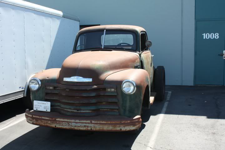

My truck is a 4400. Is that a 2 ton, or 1 1/2 ton? All I know, is I LOVE IT!

It is a 1½-ton. You'll find lots of info about it in the Big Bolts forum.

Looks like a mighty short wheelbase.What was it used for in its former life?

I'm going to guess that it was some kind of an aircraft tug.
Something along the lines of a truck that pulled things around on a yard.

Cool truck. What modifications have been done to the frame. Too short to be a factory wheelbase. Especially if it's a 4400 series. Looks even shorter than what a 4100 series would be.

Since John seems to be MIA from this thread for the past couple of days I'll chime in as he's told me all about the truck...I'm a bit jealous! (and um, how's this for my first post?)
The seller told him it was a 1 1/2 ton truck that was shortened eight feet, and supposedly the frame was "flipped" (assuming that means the suspension was flipped) so it rides really low.

Hi Damian!
Actually the axle was flipped to sit over the leaf springs. The rear was lowered when the frame was cut. Instead of joining the frame as normally, the rear most section was welded on top of the front/exsisting section. This created the 7 inch drop out back.
Johnny C
Originally Posted by dmulally
Hi Johnny,
Are you able to tell me how the front got so lowered? I noticed it says that the frame was flipped. Does this mean the front beam axle is above the chassis rails?
Cheers
Damian

Thanks Johnny,
I can understand how they flipped the rear but the front has me stumped.
Wouldnt the curve up to the kingpins be the wrong direction if the front axle was flipped?
The front of your truck and the rims are exactly what I am going for. I felt lost until I saw the pic and thought, thats for me!
Cheers
