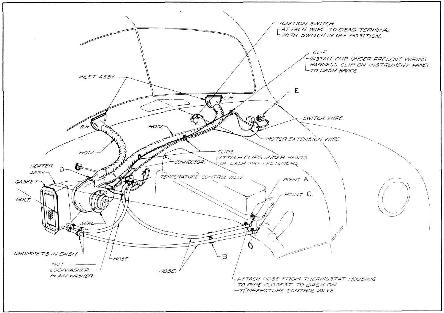

Hi Jimmi
Thanks for the info on the heater in your truck. Brad Allen posted a good reply to your post ...
https://www.stovebolt.com/ubbthreads/ubbthreads.php?ubb=showflat&Number=694294#Post694294
Looks like the previous owners of your truck and mine did not install the heater control valve.
Here are links that may help ...
Keith Hardy's index of manuals:
http://chevy.oldcarmanualproject.com
1951 Chevy Accessories Installation Manual
http://chevy.oldcarmanualproject.com/accessories/1951am/index.htm
1951 Truck AirFlow Heater
http://chevy.oldcarmanualproject.com/accessories/1951am/51aim36.htm
Diagram
http://chevy.oldcarmanualproject.com/accessories/1951am/images/51aim38a.jpg
Thanks to all for your help,
- Lonnie
