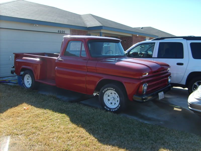

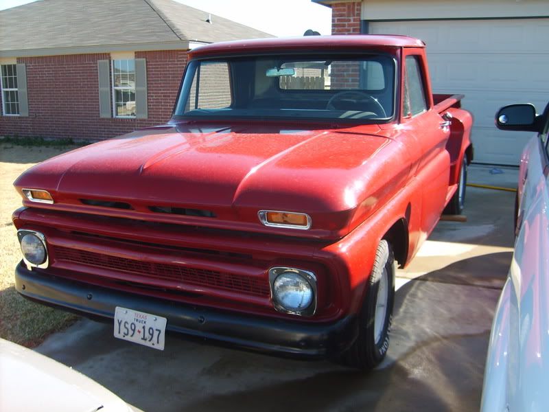

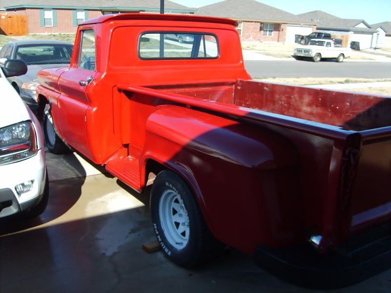

Okay here goes, lets see if i know how to do it. Sorry its dirty, it just rained.
pic 1
pic 2
pic 3

Nice truck! I'm fairly positive that those are not the original stock wheels... Someone that actually knows will chime in soon I'm sure.
As for you, Welcome back, glad you made it home safe, and thanks for serving! You, and all of our soldiers, have been in my thoughts and prayers and those of all of my family and friends. I have many over seas currently and have lost a few as well.

Hi there Rich! Looks like you have a great truck!
I'm pretty sure, too, that those aren't the stock rims. A '63 Chevy that I got the rearend out of had almost the exact same rims, and they weren't stock...
I keep 235/75 r15 tires on my '61. Of course my truck has 15 inch wheels, and the rims are in no way stock, haha!

Welcome, and thanks. I have a set of those wheels on my 64' and they came from an early 70' Datsun P/U.(just because the price was right,FREE) Good looking truck you've got. I set my timing at 6 degrees without the vacuum, around 700rpm. Just recently installed the Pertronix unit in it, and it's starting and running better now than ever before.

Definetly not stock wheels. Those were readily availale from just about all of the wheel makers in one form or another over the years, ARE called the the Wagon Wheel, i've seen other names for it too. Nowadays, seems that the only new use for them is for trailers, as thye're not a popular seller for vehicle use.
The stock tire size will be 6.70-15, approximatly a 215/75.15 in a modern tire.

welcome, nice truck its really clean.

If that is dirty, sure would like to see it clean...she is pretty!
