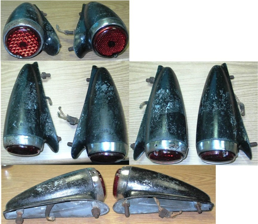

I was ready to drill the mounting holes for my bullet rear lights using the template that Tim sent me. Well, my lights are apparently not the correct ones. They match the contour of the truck body perfectly, but the mounting holes are 5 inches apart and beside each other rather than above each other. The unit is about an inch longer than the correct one. The stainless bezel and lens are identical. Is this likely off an old car or wagon? Did the lights change during the '47 - '53 series? It does have a GM part number on it, 922144, it also says Guide made in USA. Also says OLDSIG on the top as well as the lens.

You actually have a Oldsmobile or Pontiac light. The Bullet lights that you are looking for are found on 1939 Chevy cars, 1949 - 52 Chevy/Pontiac/Oldsmobile wagons and 1948 - 1955 Panels, Canopy Express and Suburbans. Check your email. ..g
I think the unit for a Chevrolet car is a single filament lamp, but it is the same size and same mounting bolts as for a 47-55 panel body truck tail/stop lamp RPO.

I did a google search and think it may be from a 38 & 39 Oldsmobile.
Joined: Oct 2004
Posts: 1,780
Joined: Oct 2004
Posts: 1,780
I think these are from a 1938 Oldsmobile
http://www.taillightking.com/images/35-50_Olds/37_OLDSIG_Olds_TLAssys.jpg
The 39 Pontiac has a removable base and a neat looking stainless trim that is on the top. When the base is removed it looks similar to the 39 Chevy lights, but has two inline studs about 4 1/2" apart.

Yep, they are the ones I have. They fit the body contour perfectly and I paid around $170 for them so I will likely put them on. I need to cut out a rubber gasket.

Yes I used the template, but I have lights from a 38-39 Olds. They are supposedly interchangeable.
1953panel,
Can you post a photo of the mounting side of one of the lamp bodies?
I have original NOS lamps on my Suburban. However, the panel truck's rear-door "stops" are different from the suburban rear-door "stops". The panel stops allow the doors to open wider.
Nonetheless, I am surprised and disappointed to hear that the factory-style dual rear side-lamps hit the rear panel-doors. Let's see if we hear from other 47-55 panel-truck owners who have installed rear side lamps.

I wouldn't say they are interchangeable. 1937 OLDSMOBILE TAIL LIGHTS mount differently because of the mount that they are attached to. That brings them out at a different angle. My guess is that you compensated for the angle and moved it forward on the belt line, thus interfering with the door. But this is strictly a guess, do you have pictures?
