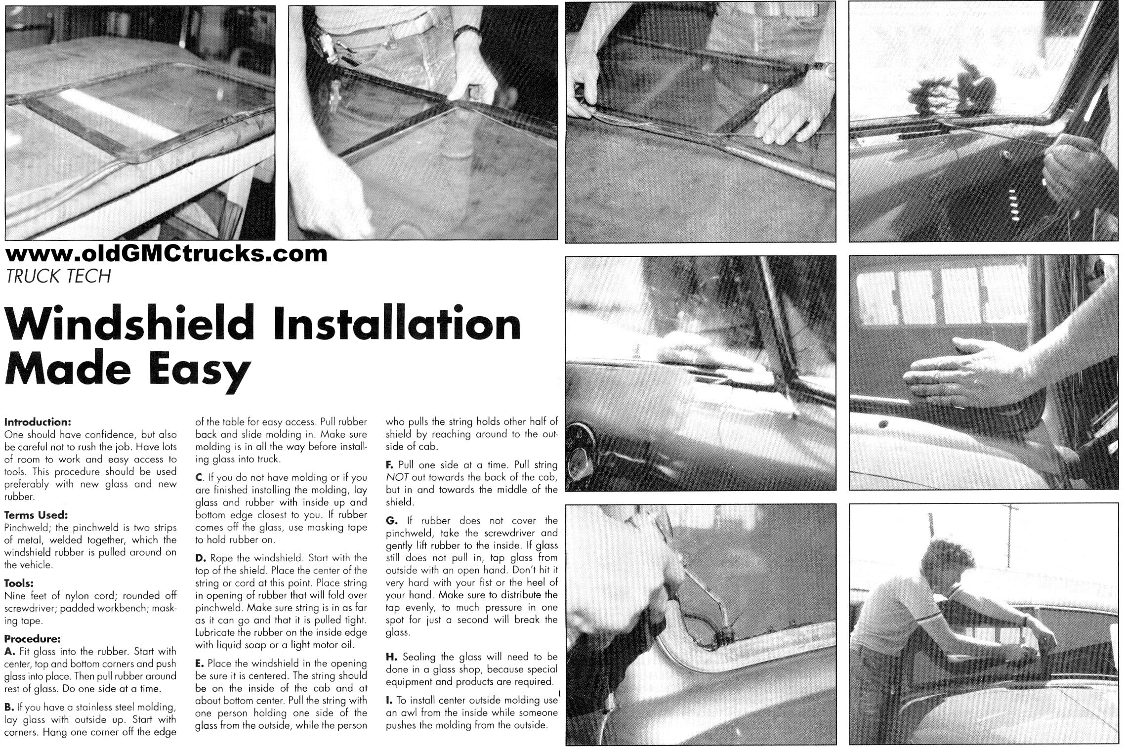

Hello,
I was wondering if anyone could give me some tips on how to install my windshield into my 53 chevy 5 window pickup. I installed the corner glass and the rear glass, which wasn't so bad once I figured out that soap makes the work a lot easier! Any tips would be greatly apprectiated!

Thanks man, you rule!

i put a little string in the rubber grove, and someone pulls string slowly, as somebody else lightly pushes on the glassit sets pretty easy that way

What about sealing the windsheild/back window once they are installed? Is that necessary or does the rubber gasket do the job well enough?

mine for the most part did well by itself, unless we get an ungodly down pour then the lower outside corners seep a little

I read in an article that you have to take your windshield to a glass shop to get sealed.

I paid a guy to come and seal up my windshield and rear window ... they both had leaks when I first got my truck.
It cost me $80 to learn that all I needed to do (myself) was to squirt some clear silicone caulk under the rubber!

Thanks Alan-
The instructions posted on intalling the glass says to take it to a glass shop for sealing and I figured it would be something easy that I could do myself!
Did you use any particular kind of clear silicone or just whatever type you find at the hardware store that is clear, like clear silicone bathtub caulk?

Read somewhere that the repro rubber is not as thick as the original and that could cause leaks. I know mine leaks at the bottom corners during a heavy rain.

Get the clear "Window & Door" silicone (for outdoor use).
