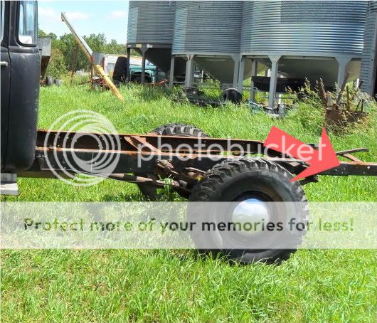

My 1949 Chevy 1 ton also has a riveted on 1ft frame extension, but i beleive mine was a factory cab and chassis model. Heres a picture of the rear frame i have: rear frame

I think we clearly identified that frame extensions from the factory exist, but does anyone know why? I mean I have a pickup without and a panel with? It's got me thinking!
