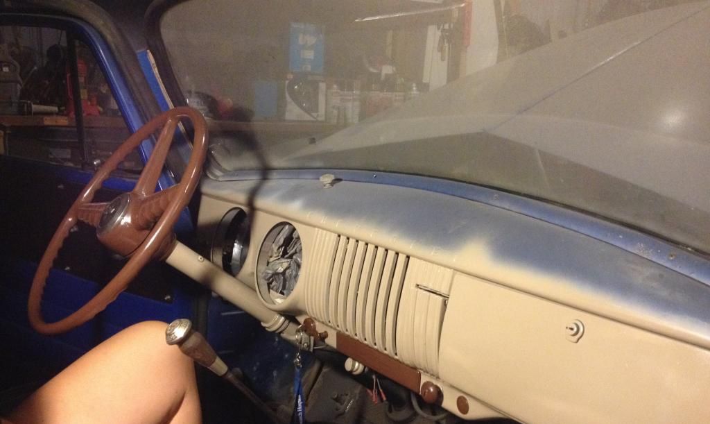

Finished up all the new wiring other than the head/taillights and the gas tank.
While the gauges were out, I went ahead and painted the face of the dash (I'll paint the top in brown when I take out the windshield).
dash

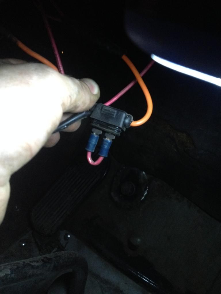

Here's on of the old wiring 'fuses' I removed:
old "fuse"
eeeek

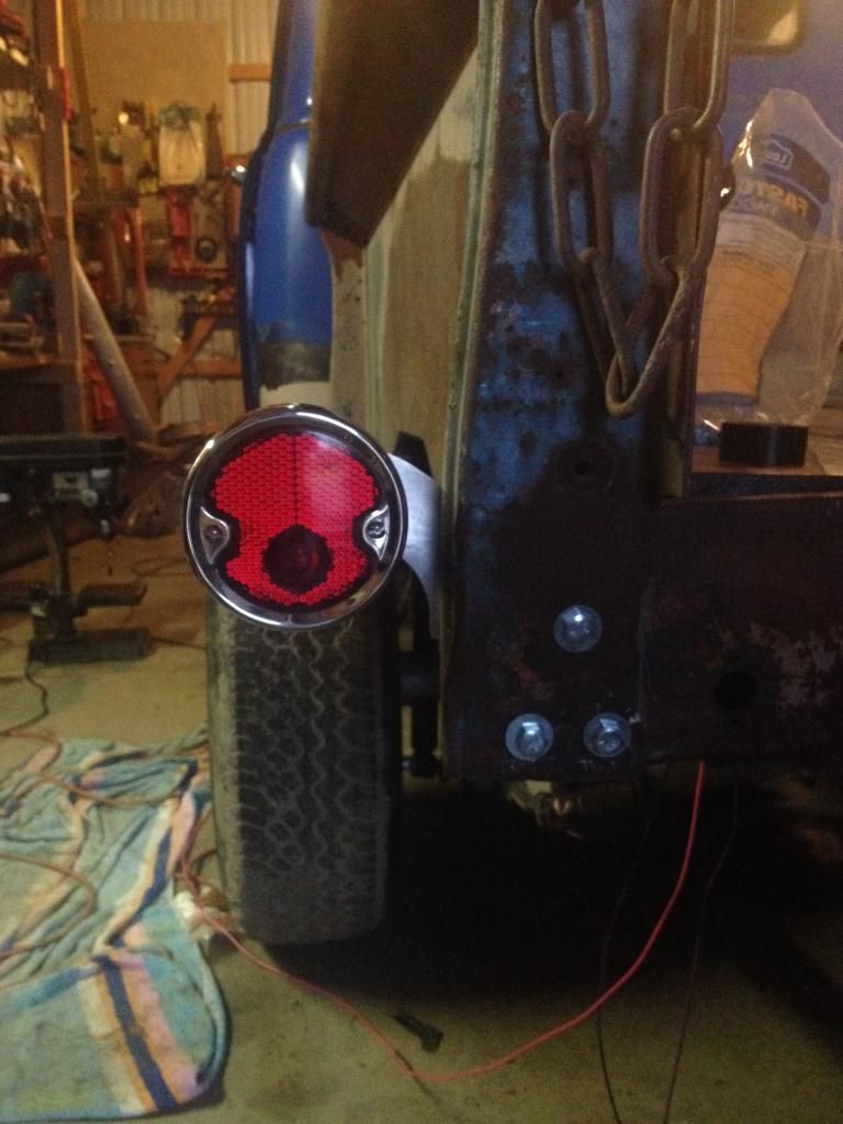

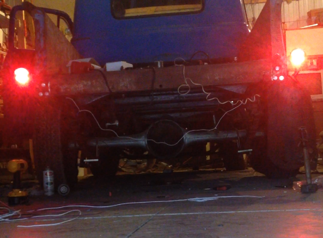

Got the taillights on and hooked up! yahoo
One step closer to being on the road....
taillight
They work and they're pretty bright!

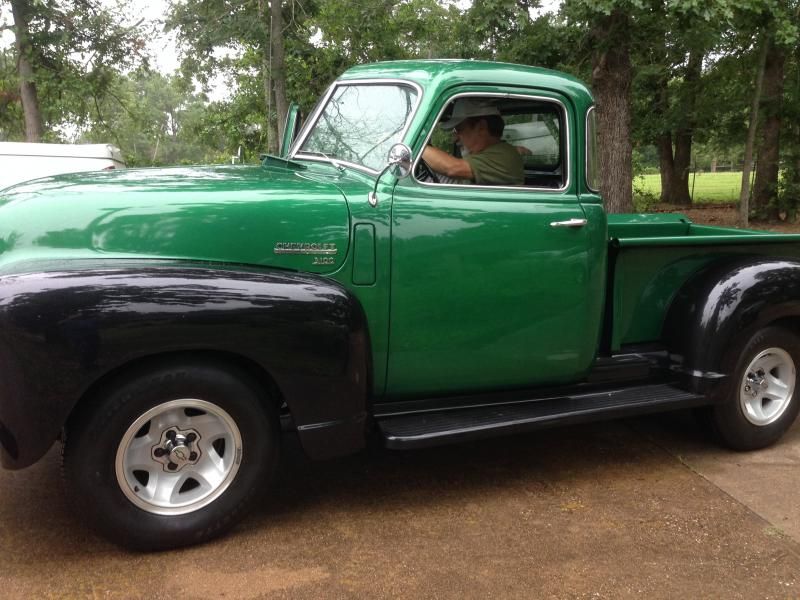

It lives and drives again after 22 years!!!
my 6 y/o son did the awesome camera work ;-)
