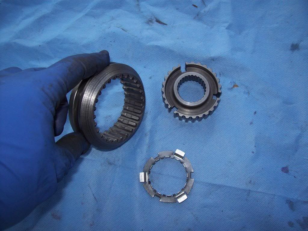

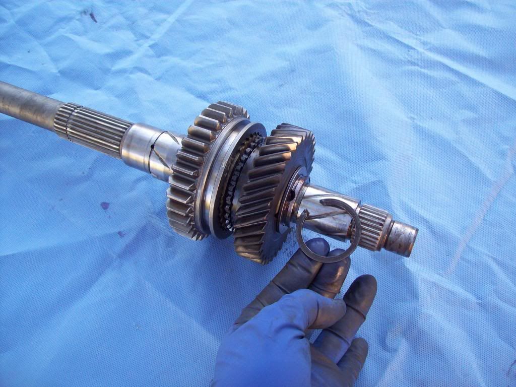

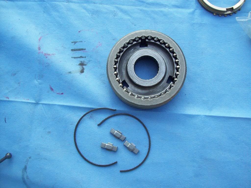

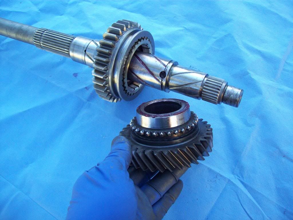

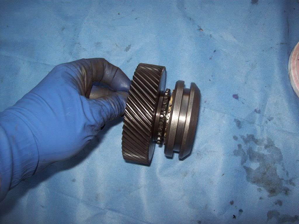

This is a BIG project for a novice like me. Perfect time of year to do it because I can do it INSIDE!
T5 transmission rebuild. It will be a non-world class V8 Camaro case and V8 gears but have an S10 main shaft, S10 tail housing and lid - a custom build. I will be able to run a factory cable speedo AND I won't need to buy an adapter plate.
First gear is 2.95 and 5th is 0.73 for highway cruising with my 250ci L6.
I hope you enjoy the pics below. Visit my BLOG for more details.

http://i1278.photobucket.com/albums...ff/T5%20rebuild/100_1581_zpsc483d246.jpg
http://i1278.photobucket.com/albums...ff/T5%20rebuild/100_1584_zpsb469543e.jpg
http://i1278.photobucket.com/albums...ff/T5%20rebuild/100_1586_zpsdf284bef.jpg
http://i1278.photobucket.com/albums...ff/T5%20rebuild/100_1588_zpsa5b6dfea.jpg
http://i1278.photobucket.com/albums...ff/T5%20rebuild/100_1593_zps729be39a.jpg
http://i1278.photobucket.com/albums...ff/T5%20rebuild/100_1597_zpsbe5c8605.jpg
http://i1278.photobucket.com/albums...ff/T5%20rebuild/100_1600_zps74417032.jpg
http://i1278.photobucket.com/albums...ff/T5%20rebuild/100_1613_zpsa8641ace.jpg
http://i1278.photobucket.com/albums...ff/T5%20rebuild/100_1617_zpsb0ffe1a6.jpg
http://i1278.photobucket.com/albums...ff/T5%20rebuild/100_1627_zpsac1305a7.jpg
http://i1278.photobucket.com/albums...ff/T5%20rebuild/100_1629_zpscbe79059.jpg

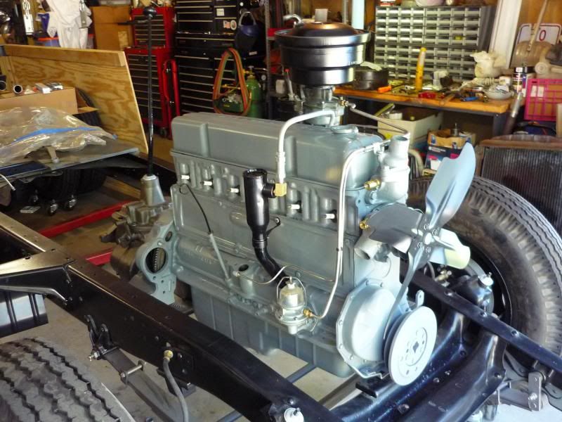

Weather was NOT frightful today (40's)... went out and put a new clutch, and put a 230 in my truck!
