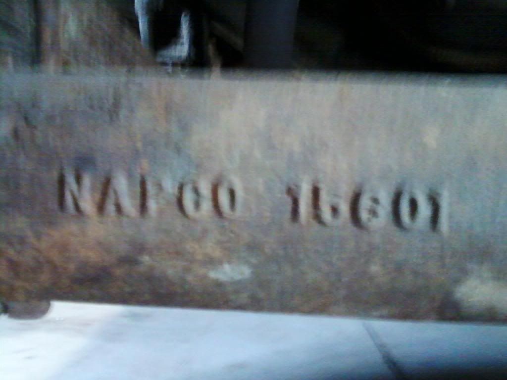

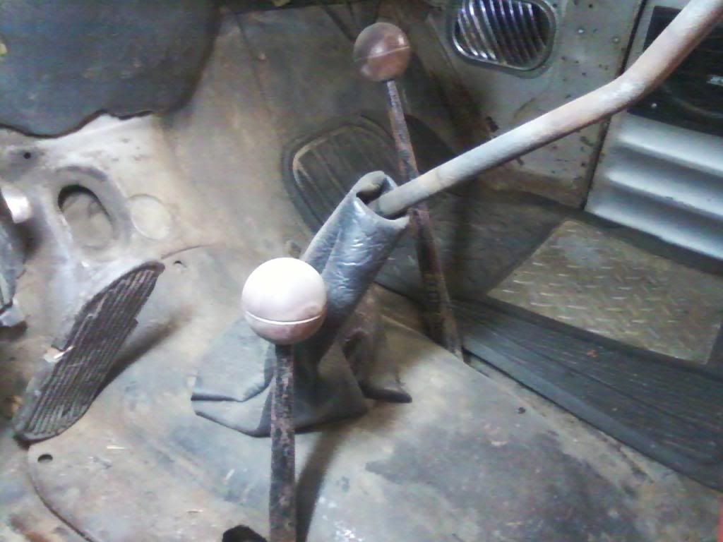

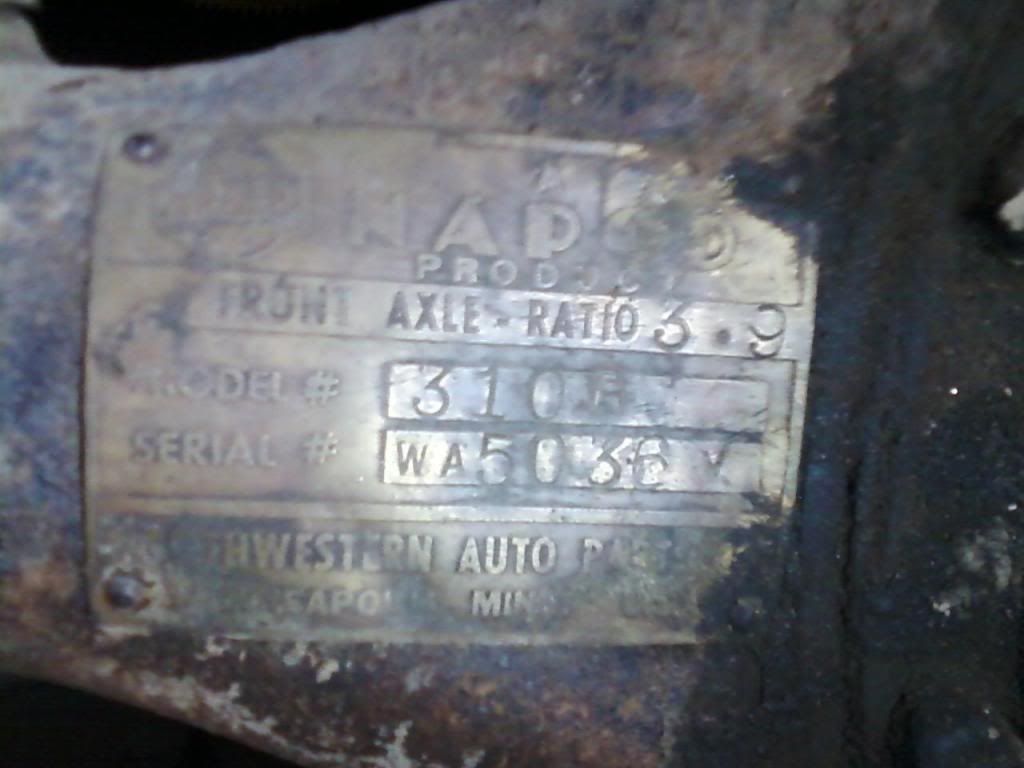

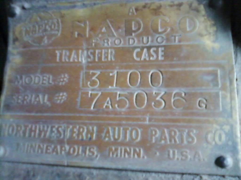

I knew the truck was a four wheel drive and had manual lock outs, but absolutely had no idea what I was about to uncover. After cleaning out the box of many extra parts, garbage, and a few unidentifiable items (two of which were moving) I moved on to cleaning out the cab. After another big pile of debris, I noticed the two shift levers, one each side of the transmission shifter. I thought, wow! Immediately crawled under the front of the truck, looked at the front axle, rubbed some dirt and grease away, and found a Napco casting, and a Napco tag. Fantastic! Flipped the transfer case over (which had been sitting in the box of the truck) and found a second Napco tag. Anybody ever do a happy dance?

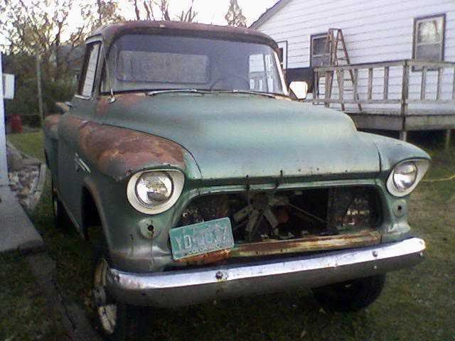

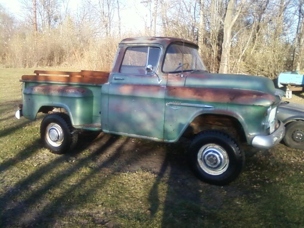

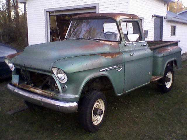

After much cleaning, the truck appeared as in these photos.

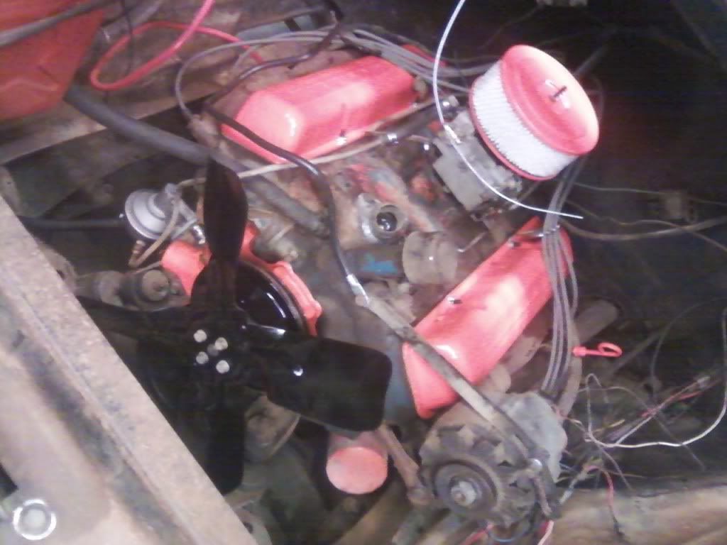

Finally got truck in my shop, and made sure motor was free, transmission worked in all gears, and the clutch was not stuck. Time to make the motor run. An oil change, spark plugs, plug wires, cap, rotor, points, coil, and some research to discover the motor was a 1966 283. Some fresh gas, turn the key, hit the starter button, timing adjustment, and the motor came to life with a belch, smoothed out, and purred like a content kitten. Fantastic! After getting it to move, next project was to get it to stop. After tearing down to check brakes, I figured out why transfer case was in box of truck. Front axle was a 3.90 gear. Someone previously had changed the rear axle to a 4.56. That meant I had to find another rear axle, but needed it to stop anyway. Rebuilt all wheel cylinders, replaced master cylinder, bled brakes, and was rewarded with a nice, strong brake pedal.

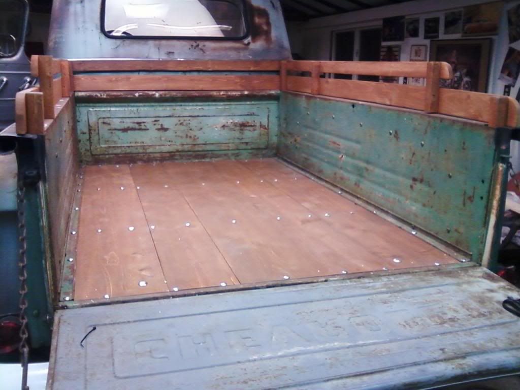

Bored with mechanical fixing, changed my sights to cosmetic repair. Stripped and repainted the grill, painted the rear bumper, installed seat (all swap meet finds) and decided to put in a poor man’s floor in the box, and box sides simply because I like the look .

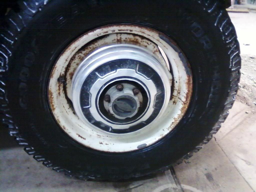

Last, the rims, recieved a sandblasting, primer and paint. Even the spare.
