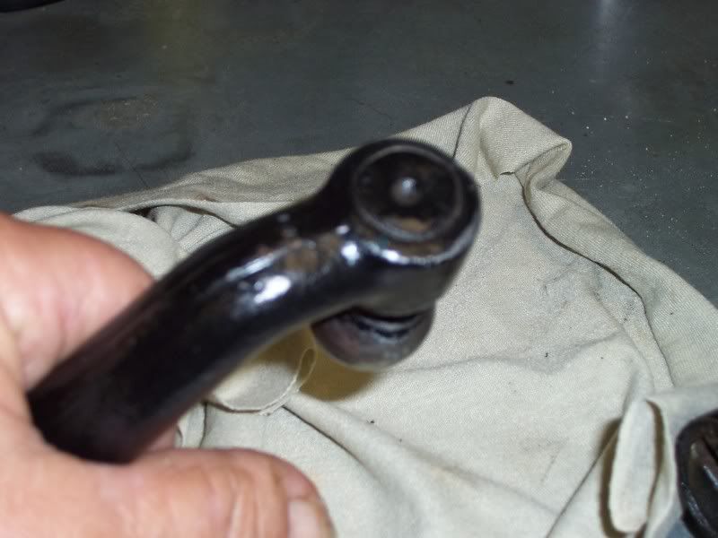

I picked up a set of replacement tie rods at classic truck parts. I took the old ones apart and was going to install the replacements. I was following along with the shop manual and was making good progress. I couldn't figure out how to get the ball stud that the tie rod end fits over out of the steering arm.
I found a tech tip that talked about trying to press the ends out. It sounded like it was really hard to do and required special equipment. Does anyone have a secret to removing the ball studs? If not, I'll take my new ends back to the store and trade them in for a tie rod rebuild kit.
There has to be an easier way to do this.

If the ball is not worn to bad than just check for broken springs and readjust.
If you do replace the ball then drill out the center of the stud part so it can collapse in on it's self, than drive out.

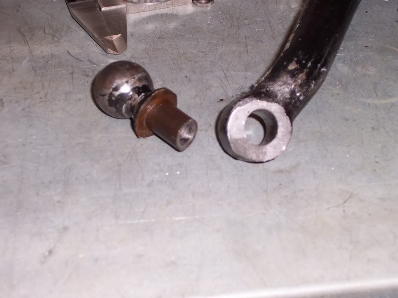

I did just what Alvins pictures show. I used a dremell and ground the bottom of the ball stud, the stud is flared out. I ground around the outside edge till I could see the center of the ball stud. Then a long punch and a 3lb. mall and a few well placed hits and it was out. Might have taken 15/20 minutes to do both arms.( I had two extra arms off of another front end)

Look at the first and last pictures on Alvins post,You can see how the stud is swagged over/peened. this is were I ground the stud not the steering arm. As you grind around the inside of the arm, you will see the ball stud shaft, when you do, that is when the hammer and punch come in. good luck.

...and you don't need a drill press. Just drill down the center for a ways to help it "collapse" and come out.
...when I ground mine down there is usually a little "dimple" in the very center that you can still see. Let us know how you come out if you do it.

Larry, I just removed my ball studs this past week, (1950, 3100). I found after grinding off the peened/swagged area on the back and drilling a 3/8" hole about 1/4" deep I had trouble. I used a big, heavy hammer and then a 5 ton ratcheting press to no avail. Maybe I should have used a larger drill bit? Anyway, I called a local auto machine shop and they quoted $65.00/hr and 1 to 2 hrs work depending on how hard they were stuck. I asked him how big his press was and he said 20 ton. Heck, I ran out and used my $149.00 Harbor freight coupon to buy a 20 ton press. About 1/2 hour and they all came out nice and easy. So my press is half paid for!

I ground the peened area flat, drilled a hole I guess 1/2 deep and then hit with big hammer. Nothing happened, Then after staring and thinking about it, I took the dremmel and ground around the inside of the arm till I saw the outline of the shank of the ball stud. Them a couple of well placed hits with a punch and 3# hammer the studs were on the work bench.

Ok. I finally found the time and motivation to tackle the tie rod ends. Once I got the electric grinder and bench vise from HF, it was a piece of cake. It took some significant persuasion to get the ball studs out; even after I ground the flange off and drilled them out.
