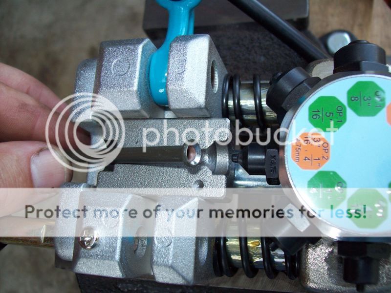

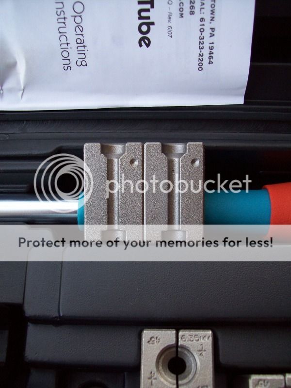

I read through this older thread and it helped me make a GREAT decision. I just purchased an Eastwood Brake Flaring Tool. Got it from Eastwood but they sell it on eBay for a cheaper price than you can buy it directly from their website. Shipping was free!
This tool is worth every penny! It was $200 delivered to my door. My double flares look correct and they are easy to make. (If you think the double flares are not made correctly, please help a newb out and tell me what should be different.)
See for yourself. These are my results from my very first flare.
http://i618.photobucket.com/albums/...wood%20Brake%20Flare%20Tool/102_0488.jpg
http://i618.photobucket.com/albums/...wood%20Brake%20Flare%20Tool/102_0494.jpg
http://i618.photobucket.com/albums/...wood%20Brake%20Flare%20Tool/102_0493.jpg
http://i618.photobucket.com/albums/...wood%20Brake%20Flare%20Tool/102_0491.jpg
http://i618.photobucket.com/albums/...wood%20Brake%20Flare%20Tool/102_0490.jpg
http://i618.photobucket.com/albums/...wood%20Brake%20Flare%20Tool/OpenBox1.jpg
http://i618.photobucket.com/albums/...ake%20Flare%20Tool/threesixteenthdie.jpg
Here's the video from YouTube.
Let me just say that I bought an old school flaring tool but it was junk. Never made a good flare - not even one! The die made a scored line and ridge on the head of the tool! I ain't saying it can't be done with the older style, but I lost a week of time and my heart sank when I saw the cheap tool wouldn't do the job.
Your flares look better than the ones I make!!!
Posts: 8,878
Posts: 8,878
Might be the same as the Brakequip by looking at your pictures, exception of the decal on top of the turret.
Comparable price too.

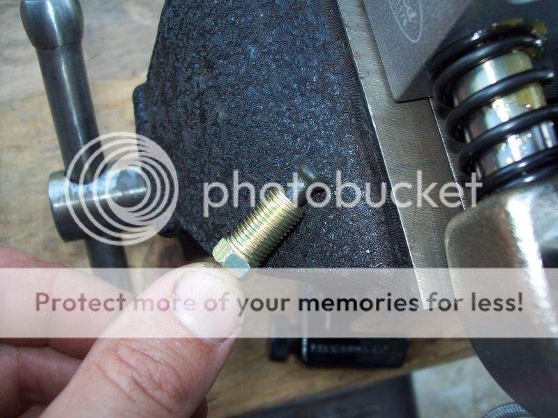

Is the steel line to the oil pressure gauge flared? It is 1/8 inch steel on mine but it doesn't look like a flare. Either it is different than larger tubing or mine has had some McGuyvering done to it. I was working on my throttle linkage and next thing I know there was an oil fountain from the side of my block. I had touched the connection, but it should not have done that. And thinking of it, most of the steel line connections on my oil system (261 CID) seem a bit weepy.
Joined: Apr 2013
Posts: 101
Joined: Apr 2013
Posts: 101
I can't see the first link Tim - but it does look like the fitting. How does it seal? Now it just looks like a bulge past the fitting - not a flare or compression.
Posts: 14,526
Posts: 14,526
...as you tighten the tube nut it squeezes down on the line and seals it off. I THINK it depends on what your screwing it into for it to work like its suppose to.......someone correct me if I'm wrong.
For what its worth. I bought 10 of those threaded tube nuts from NAPA so I'd have extra's. When I hooked up my guage it took me TWICE cutting the ends off and using a new nut before I ever got it to quit leaking a drop every now and then...... I could never tell if it leaked around the threads or leaked between the copper line and the tube nut.
I'd be interested in what others have to say about this...if they had the same leaking problem.

Alvin, it seems to have done exactly what you describe, but I don't know what causes that action. I tried to fit a compression sleeve but there was not enough room. So I pushed the copper tubing through, pushed it to the bottom and tightened the nut tube and miraculously - no leaks!
By the way Tim, I can see the link now - that looks exactly like what I have.
Posts: 8,878
Posts: 8,878
The design y'all are talking about and that Tim posted links/pictures of is a compression sleeve and tube nut "all in one" piece. The end of the tube nut will crimp/compress onto the tube when it is tightened in the fitting. The tube nut is then not reusable on another line.
