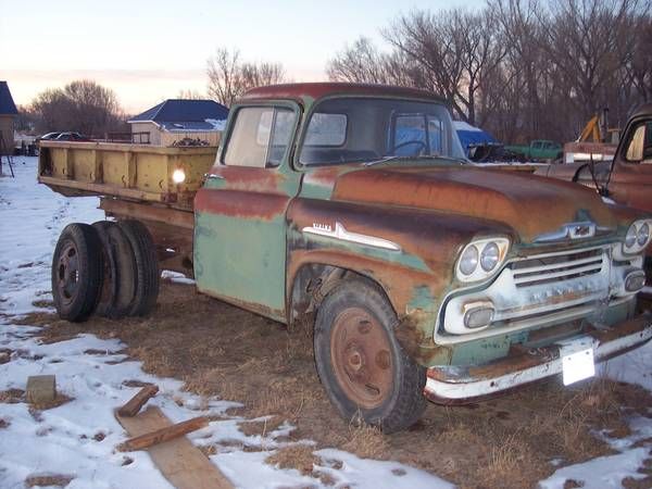

Here's the latest big bolt to join the herd.A 1958 Chevy viking.Snagged it off craigslist.Runs drives,dump bed works,brakes work...sorta.
I couldn't pass it up!
http://img.photobucket.com/albums/v312/bigtim44/58Viking_zps3a772330.jpg
I'll check it over tomorrow and post more picture links.

Old girl looks really nice. Amazing how a dump can stay the test of time with an owner that cares and tlc

Looks good. So does the price! I would have bought it too smile

I fired up the viking this morning & let it warm up while I was taking the tie down straps off,backed it off the trailer and parked it up. Here's the picture from craigslist,I'll get more pictures of it in my yard when I get a chance.

Nice truck, won't have to blast off too much paint.

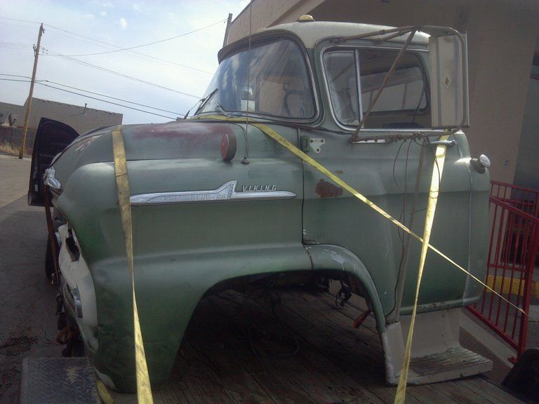

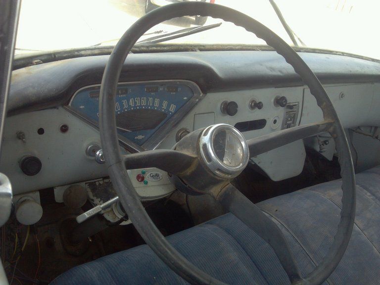

I spotted this 1959 chevy Viking 50 LCF snubnose cab on craigslist and just had to have it,picked it up in Denver today,nice complete deluxe cab,I've been looking for a 58 or 59 lcf for a while now.
I think I've also found a 1ton GM dually Van chassis to go under it.I took some pictures of it strapped down to my trailer for the trip home today.
Here's a link or two
http://img.photobucket.com/albums/v312/bigtim44/photobucket-60932-1364851999552_zps1e83f52b.jpg
http://img.photobucket.com/albums/v312/bigtim44/photobucket-26448-1364852001321_zps52f37912.jpg
http://img.photobucket.com/albums/v312/bigtim44/photobucket-26880-1364852000130_zps52e60260.jpg

Hi Bigtim 44,
Looks like a really nice truck you got there. Very jealous, I have 2 of these truck none in that nice of shape. Hopping to keep mine mostly original with some safety upgrades, for now! The emblem on the fender and hood is for a 58 and not a 59. Other than that both years are the same.

It could be a 58,it came with a bill of sale,need to run the vin to verify the year.
On a side note, can an Lcf cab be mounted onto the chassis from a regular cab truck from the same year?
Posts: 12,029
Posts: 12,029
definitely a 58, the vin will be xx58xxxx .... I doubt it'd fit on a conventional cab frame without some major work, but for frame comparisons, check the 58 resto-pack
Joined: Jan 2013
Posts: 8
Joined: Jan 2013
Posts: 8
I belive you could put the cab on the chassis from a regular cab truck(Same cab Mount Locations in both cabs), but your steps might touch the ground and the cab would be set back to far from the axle.
Also the front part of the frame would be too high for the LCF rad support( Drops about 10" to 12" below cab mounts).
Another problem would be where to put the engine I do not know if the nose would be long enough to accomodate a V8 without droping it in the frame.I am putting a late model 350 in mine and could not keep the serpentine acc. brakets. I needed to go back to the stock waterpump and V-belt pulleys.
So I chage my answer to I do Not think it would fit a regular chassis. Hope this helps?
