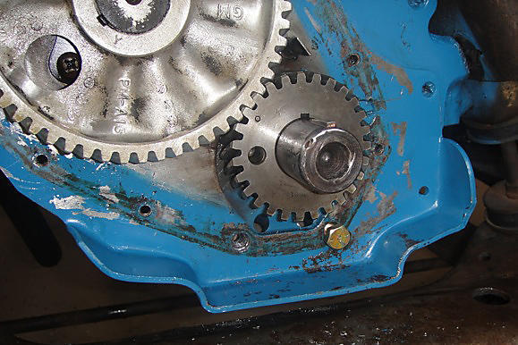

maybe the timing gear is marginal and has "jumped" a tooth -- possible if its a fiber gear. Remove valve cover and bring up to #1 tdc and see where valves are at. The rocker arms should both be loose on #1. Or have someone crank it over while you watch for rocker arm movements as there could be worn lobes--see if all rockers rock about the same amount--wiped out lobe's rocker wont move much.

Edski, here is a photo of Jim's Timing Gear. It is metal and in great shape. I think Jim is on the right track with his changing the points and more likely the condensor.
The person who gave you that tip Jim sounds like a wise guy..... chug

"Wise Guy" would be putting it mildly...
It appears I need to invest in ale.....and maybe exhaust systems...just to draw you over to mi casa again.
But, concur, I think the timing gears are okay, based on recent evaluation. Will report back to all after change-out of the condenser and points. Hopefully tomorrow.

yeah the aluminum gears just dont wear, so it must be a truck motor not a pass motor. just dont wear out the contact points plate changing out the points too many times
