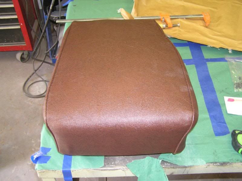

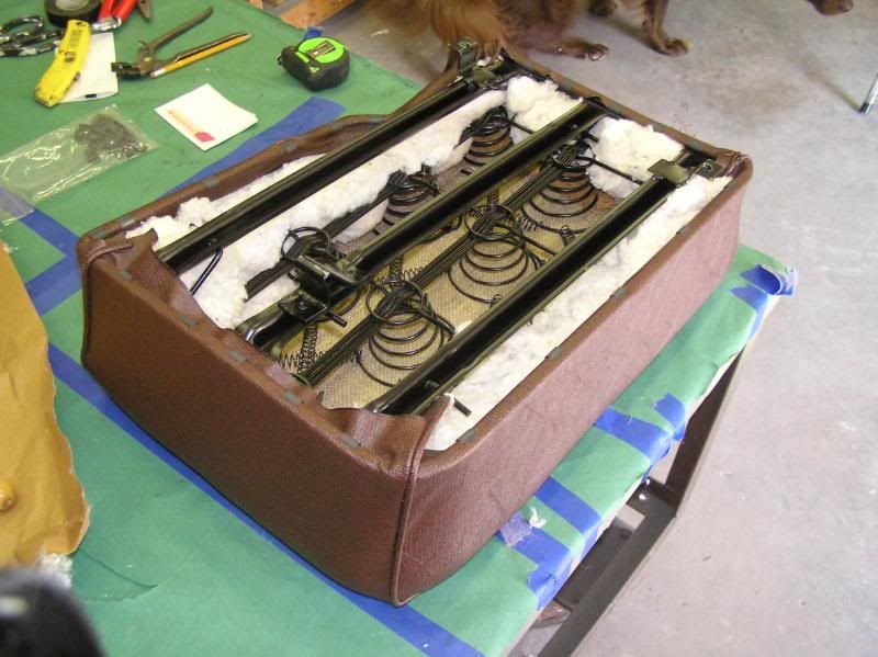

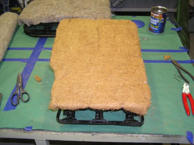

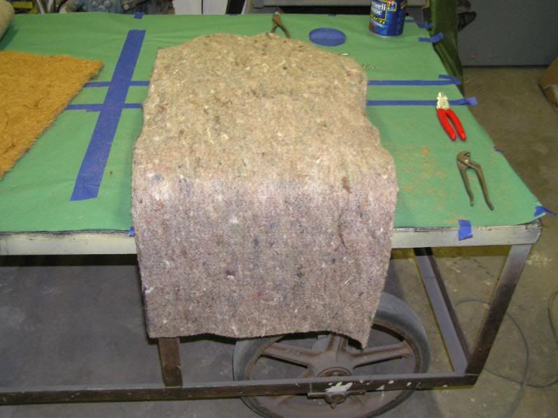

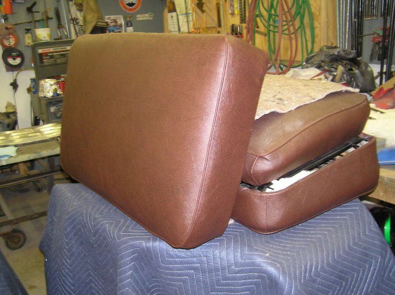

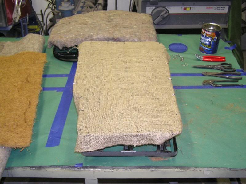

I have decided to use Jim Carters upholstery kits and cover my own seat frames.I'm using Spanish brown grain.
Here are some photos of the lower jump seat cushion.
burlap hog ringed
coir hog ringed
jute
jump lower cushion upholstered
jump lower cushion upholstered #2
If you guys want me to post all the cushions as I do them,just say so and I will add it to this thread.

....by all means Tim. Curious minds want to see. You may convince me that even I can do it?

looks really good.

so hog ring will work? Im planning on sewing new covers with my mothers new industrial machine, but worried i needed the round lil clips. looks good!

That jump seat look great! thumbs_up grin

What I think I see/read (from Tim's two posts on this project) is that hog rings were used for layers under the upholstery and the original-style c-clips were used for the upholstery.

I used original style c-clips that Tim Lederman linked to above on the upholstery material.I used the hog rings on the layers under the cotton and upholstery.
To use hog rings,I believe there is wire that is fed into the bead material.I watched a lot of you tube videos on upholstery and decided I would try it myself.

Excellent work, Tim.

ahh so i do need those then, i was studying it the other day when i pulled my jump seat and it looked like a hog ring wasent going to work.

Nice work!

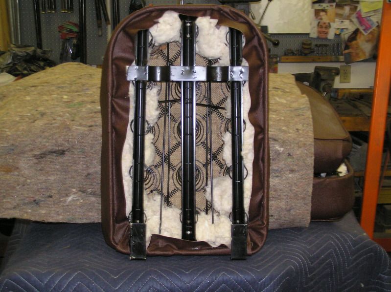

Yes it's just as you describe and yes I purchased from Jim Carter.I have a problem with the fitment of the jump seat back rest upholstery and both middle seat cushions.
I talked to Jim Saturday and I will be dropping the seat cushions off to the guy that makes the upholstery.You might want to wait on ordering them until I report back on the fix.

The upholstery shop did confirm the back cushion of the jump seat and both middle cushions upholstery were wrong.I let them make new patterns off of my original cushions.
Jim Carter told the upholstery shop to go ahead and install the upholstery for all my trouble.He's taking care of the bill on it as well,you can't beat that.

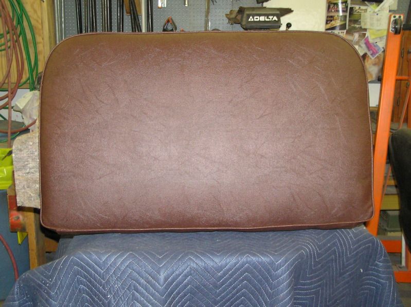

Here are couple of pictures of the drivers seat cushions I covered.Probably not perfect like a upholstery shop would do.
drivers back cushon
drivers lower seat cushion
I'll post some more pictures soon.
Thanks,Tim

Nice work! Nice shop!
Nice Tim. Looking forward to seeing it in Kansas...soon.

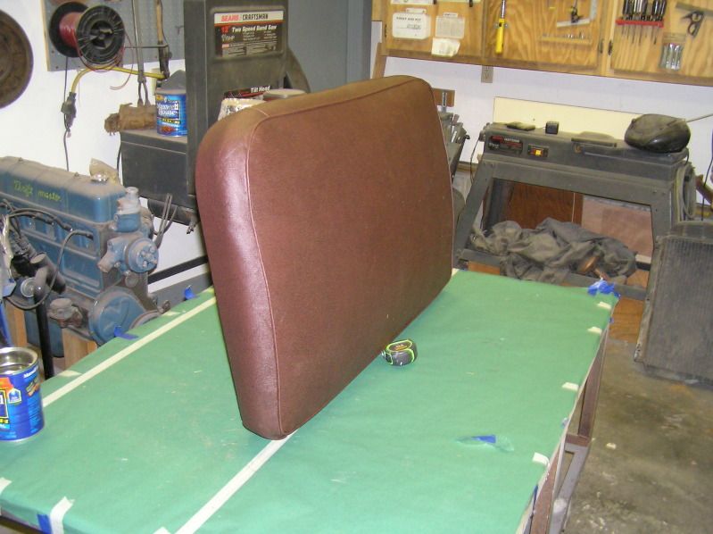

Thanks for comments,here are a few more pictures. jump seat back cushion
jump seat back cushion #2
seat cushion
seat cushion #2
middle seat lower cushion
middle seat back cushion
to view my album
I will post some pictures of the seats and cushions together,soon!
Thanks,Tim
