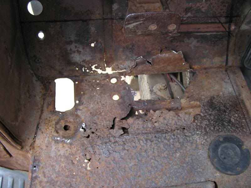

I got started on the passenger side floor pan and kick panel sheet metal.I have two guys mentoring me on this project and they actually cut out my sheet metal and told me to watch.This guys name is Gary,and he is really a treasure to have around. ready to cut out
Tony mapping out where to cut the rusty kick panel
. where to cut

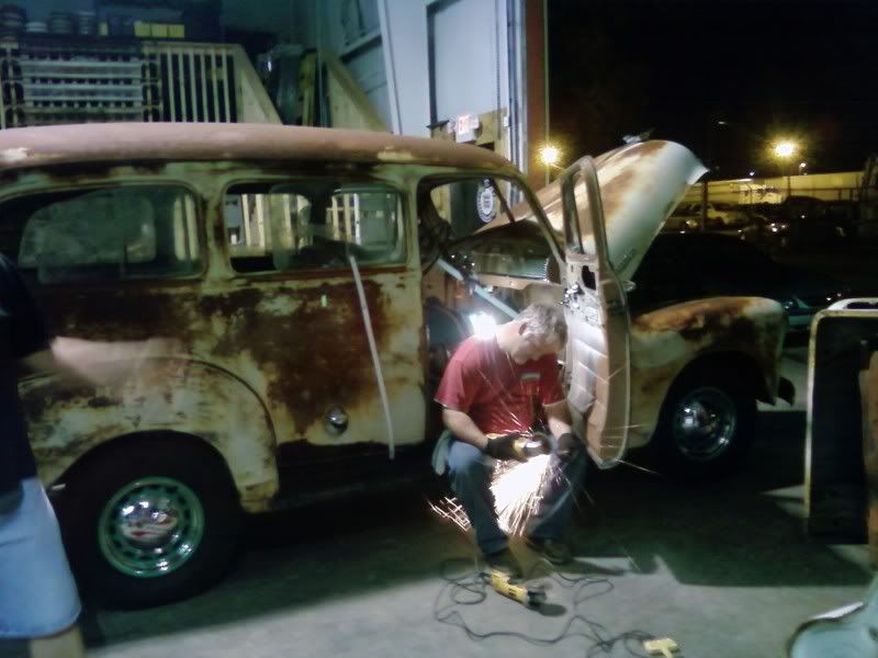

Gary cutting the rusted section of kick panel. cutting kick panel
The other guy is Tony,some of you know him for his reputation with 1960-1966 Chevrolet trucks.He smiled the whole time they were taking my floor apart,even though it was an AD suburban. Tony thinking AD trucks
The rusted part of floor cut out and kick panel. cut out
Part of the inner cowl had some rust through,I cut it out. inner cowl

Did you do all that grinding and welding with the battery in there? I had a battery blow up on me once and the first thing I do is get it far away from any potential sparks and hot stuff.
Excellent job on the metal work guys!

Friedtmater,we did do all the work with the battery in tact.I never even thought of removing it.Thanks for the safety tip.

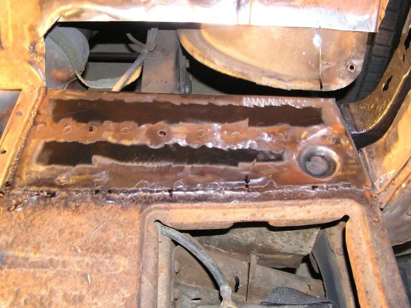

So I did get the passenger side all buttoned up for now.
floor pan
firewall side

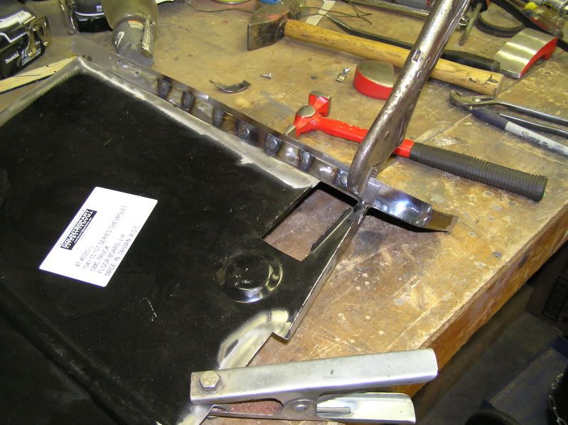

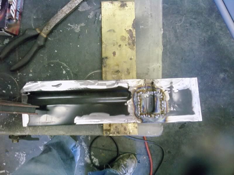

I also tackled the drivers side floor pan and kick panel.I had to cut out a bigger section.
I started out by marking the bad sheet metal to be cut out.I did remark where I needed to cut near the door opening,I don't show it in the pictures.Being careful not to cut into the inner rocker panel lip. marked the floor pan
floor pan marked
Removed the emergency brake bracket and levers.
removal of emergency brake bracket
removal of emergency brake bracket #2
cutting the sheet metal out with a small die grinder. cutting floor pan
I used a air chisel to cut the spot welds at the kick panel. air chisel spot welds
kick panel spot welds chiseled
removed the floor pan. floor pan removed
Air chiseled kick panel spot welds
I had to cut the top of the kick panel horizontal and removed it. kick panel removed

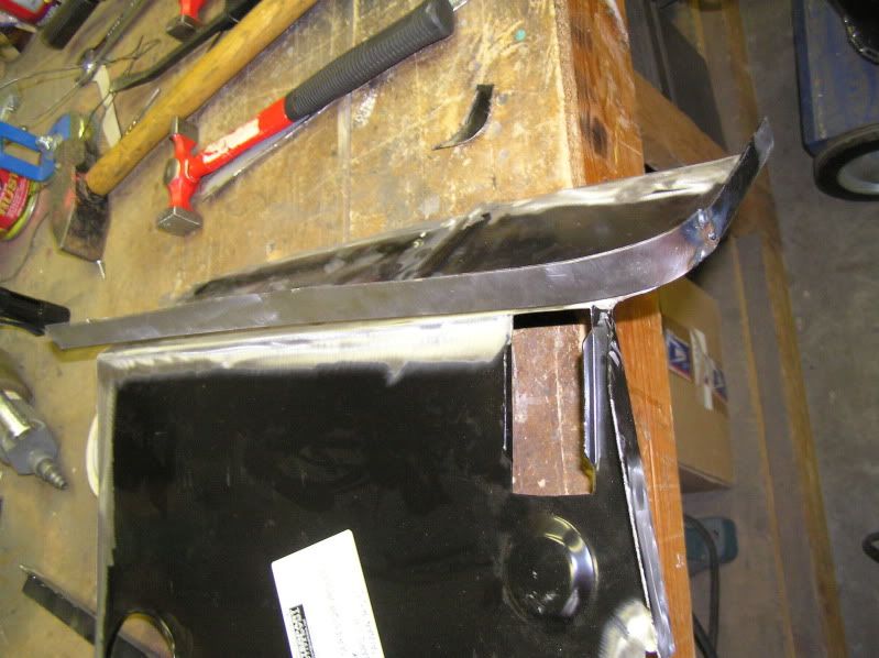

I had to cut the bottom of the new kick panel off to get it to fit.The lower part is formed wrong on the panel.I did call jim carter and he is supposed to get the tooling fixed. fitting kick panel
fitting kick panel

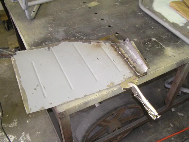

The floor pan I purchased has the toe board section on it as well.The original is two piece and has the flanges where they are spot welded together.I decided to weld on some sheet metal to represent the flanges. adding the flange
adding flange #2
adding flange#3
ground the welds
cut out for emergency brake lever
fitting floor pan
fitting floor pan #2
I spot welded the brackets to the sheet metal that hold the speedometer cable and wire harness wires. speedometer cable holder bracket
wireharness bracket clips

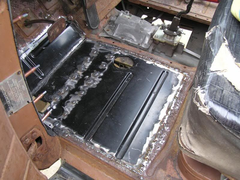

I drilled holes in the floor pan to plug weld to floor support.I also took time to clean all edges that will be welded.
drilled for floor brace
floor pan spot welded into place
floor pan spot welded into place #2
I had to reform the lower piece of the kick panel to make it work. reform for lower kick panel
