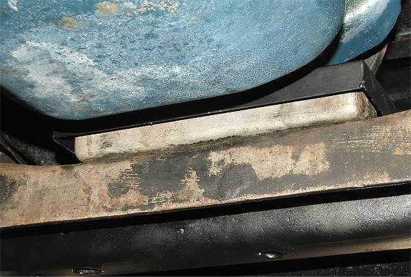

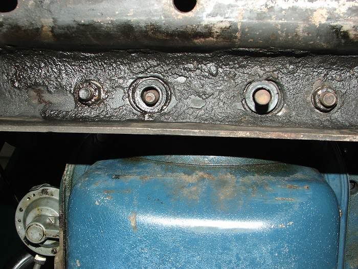

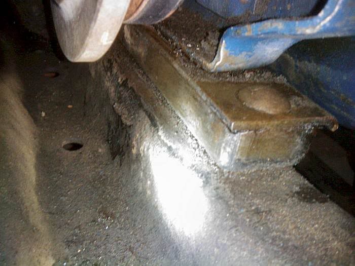

I believe that I have a problem with my front motor mount, but I don't have the knowledge to know for sure.

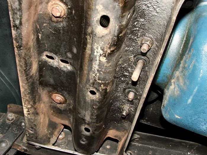

The two outer bolts on my front mount are tight. There are two hex head bolts without nuts sitting loose through front plate and the holes in the center bushings. The rubber mount cushion has some cracks.
The Shop Manual and Assembly Manual aren't clear to me regarding the center two holes in the motor mount.
> How/where should the mount be bolted to the truck?
> What hardware is used to bolt the mount to the engine and frame?
> What is involved with replacing the mount, and the rear mounts while I'm at it? I'll have a local shop do the work.
This pic is looking straight up at my front mount.
This pic is looking up from the drivers side.

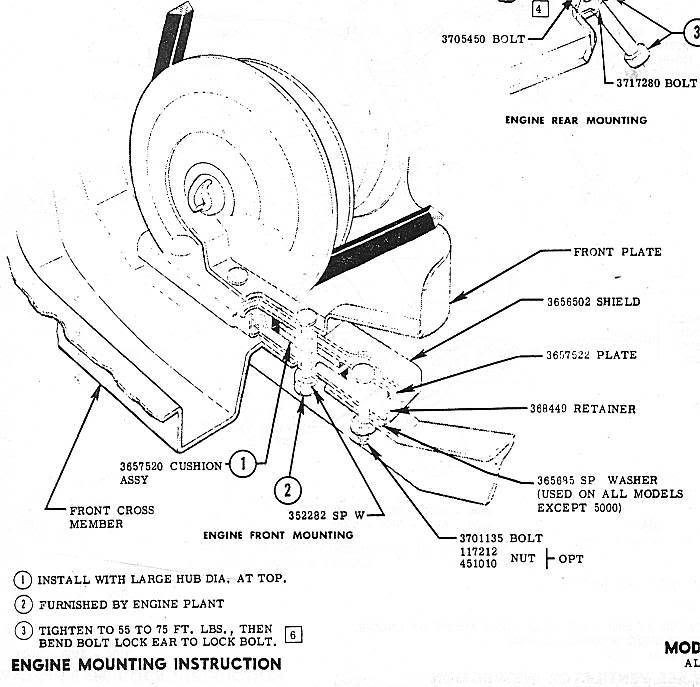

This is the Assembly Manual diagram.

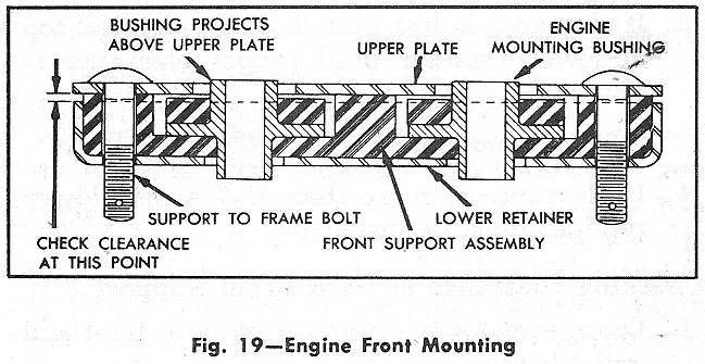

This is the Shop Manual diagram.

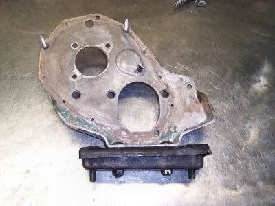

This is a pic of a mount from pugetsoundvintagechevrolet.org

Looks like you are just missing the nuts on two of the bolts. Also Most of the 'truck' vendors should have the parts to freshen up this mount and probably a diagram of how it goes together.
Best of luck

Weird! All this time and it looks like the lock washers are still hanging on.

I know that I am being thick about this, but I can't quite picture how the front mount goes together. Can someone explain to me what bolts to what?
Boltr#43 and Jim - Those flat spots around the inner two floating bolts are not washers, they are the bottom of the rubber motor mount cushion.

>> What was the bolt or stud labeled "FURNISHED BY ENGINE PLANT" in the Assembly Manual diagram?
I cross referenced the bolts and washers in the Assembly Manual with the '54 Master Parts Catelog:
Bolt #3701135 is 3/8-24 X 1-7/8 Carriage Bolt
Washer #365685 "SP WASHER" is 3/8"ID X 1-1/4"OD
Washer #352282 "SP W" is 7/16"ID X 13/16"OD

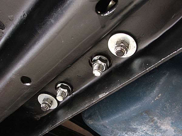

Not sure what you’re asking Lonnie, but here are a few pictures
of how the front mount should go together:
http://www.pbase.com/dennygraham/image/128165791/large
http://www.pbase.com/dennygraham/image/128165811/large
http://www.pbase.com/dennygraham/image/136995331/large
Denny G

Nice pics Denny. Isn't it simply two bolts to hold the mount together and to the crossmember and two bolts to hold the motor to the mount/crossmember!! From Lonnie's pics it looks to me like he is just missing the two nuts to hold the motor to the mount and crossmember.
....its been awhile since I had one apart so I may be off my rocker!

I'm starting to see why I am confused about the mount. Your pics show that I am missing a piece ... part #3656502 "SHIELD." I hope that is the piece that I have on order.
Here is a close-up pic of the top of my motor mount. No shield. It looks just like the the diagram in the '54 Shop Manual. I guess the Shop Manual diagram does not show the entire mount. I believe that the bump on my plate is the head of a carriage bolt, not a dimple in the plate. The two center bolts are just sitting on the front plate. They are not secured to the cross member. I can poke them up with my finger.

Yes you are missing the shield. Just about everyone that I've seen is pretty well chewed
up by the time the rubber needs to be replaced, that's why the shields are sold by most of
the vendors. The shield is just that, a shield to protect the rubber, it’s probably left out of
the illustration for clarity as it‘s not actually part of the support mechanics.

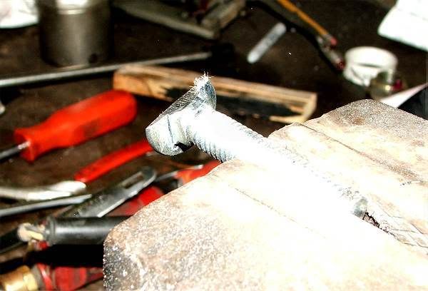

The first picture I posted shows the shield that I made. The square shoulder under the
head of the carriage bolt has yet to be pressed into the holes on this one. Here is the link
again: http://www.pbase.com/dennygraham/image/128165791/large . You can scroll thru
the rest of the pictures in the album by hitting the [previous] & [next] buttons in the upper
right corner.
The bolts are special, they are not standard carriage bolts because they’re fine thread and
carriage bolts are course thread. My bolts were in good shape so I reused them but if I
had to make new ones, I would buy longer bolts, cut them to length and re-thread them
with a fine thread. The center bolts clamp the front motor plate, the upper plate and the
engine mounting bushing to tightly together. The outer bolts are tightened down just
enough to get the gap shown in the manual. This leaves a little float in the rubber cushion.
The reason for the castle nut on the outer bolts is because they are drilled for a cotter pin
much as your spindles are and after you adjusting the gap you pin them.

I'll have all the parts including bolts, nuts, and washers ready. The radiator will be flushed ready to remove. And I'll give and discuss a copy of the Shop Manual, Assembly Manual, Stovebolt Tech Tip, and the replies to my post. We will discuss Denny's 4"X4" jig to avoid damaging the oil pan. I'll make one if needed. We'll also discuss removing the harmonic balancer as described in the Tech Tip.
The only thing that may cause a delay in the installation is the clearance between the top plate and the lower retainer of the front motor mount assembly. (3/64" to 5/64") Hope we don't have to file the lower retainer. An even bigger hope is that the clearance is not too large, as Gus quoted.

In more realistic terms those dimensions are guite small,
.047"-.078"(3/64-5/64"). What they are really trying to say is
you want "some" clearance between the top plate and retainer.
Don't worry about there being to much cleareance, you won't
have that and even if you did have as much as .125"(1/8") you
would still be fine. The technical writer had to put something
down so he picked that for a range.
As far as the support, that was simply my way of doing it with
out hanging it from the top while I removed the rear mount, you
just want to be sure that you don't dent the pan.

One final question (I hope.)
Is there any secret to installing the 7/16" carriage bolts into the two center holes of the front motor mount? Does the timing cover or harmonic balancer need to be removed? The two center bolts were originally installed by the engine plant, so the Assembly Manual and Shop Manual do not show how they are installed.
The Stovebolt Tech Tip about front motor mounts says that "the assembly needs to be installed before you install your harmonic balancer."
I'm taking it to the shop this Friday to have the front and rear motor mounts replaced. I have all of the parts, plus some 7/16 hex bolts in case they can't insert the two center carriage bolts. If needed, the hex bolts will be inserted from the bottom and nutted on top. Trying to avoid doing this.
Pics by Don "down2sea" McLendon, author of the Tech Tip;
> Front view without mount
> Front view with mount installed
> Side view with mount installed

I also would avoid installing the front motor mount bolts from the bottom. When I got my 1951 they were installed that way, after some miles on it I ended up with no bolts holding the motor down in the front.

This doesn't sound good. If all of the screws are removed, can the timing chain cover be moved a little to allow the 7/16 carriage bolts to be inserted through the front plate?
Any suggestions on how to make this work?
What are my best alternatives? I'm not gonna pull the engine.
- Lonnie

I'm getting a little nervous. Can you tell me the best way to insert the two center bolts of the front motor mount through the front plate?
How did you replace the two center bolts when the engine was in the truck?
If 7/16" carriage bolts won't fit without removing the harmonic balancer - what should I use? Diameter? Special heads/nuts/washers?
I think that I've figured out that removing the timing cover is not an option.
I'm taking it to the shop Friday morning. Thought that I had all the parts including bolts and nuts. Now it looks like I need different center bolts.
Guess I haven't learned as much about motor mounts as I thought!
Thanks for your help.
- Lonnie
My '54 3104

The current center bolts are 3/8-24 hex head with no lock washer under the head. The non-threaded shoulder of one extends below the area needed for the nut to thread onto. Both center bolts are sitting loose in the holes - not nutted.
< PIC >
I figure that a previous owner discovered that he couldn't insert 7/16" carriage bolts through the front plate after he had assembled the engine. Don't know why he chose the long-shouldered bolt. Also don't know why he didn't secure the nuts better. It's never had nuts on the center bolts since I have owned the truck (12yrs). I believe that one of the bolts on the side motor mounts was missing when I bought the truck. The weight of the motor was all that kept it in place!
- Lonnie

You can insert the center bolts but you have to take a little (tiny) bit off the top on one
side and bottom of the other side of the square hole with a rat tailed file. Then you can
angle the bolt just enough to get it in with everything in place and the square still locks
the bolt from turning. Originally the bolts were lightly crimped in place on the front plate
but they usually work loose. If you could find a NOS front plate it would have the two
bolts locked in place with the square crimped in a little.

SUCCESS! The new front and rear motor mounts on my '54 3100 235 are in. Thanks to all of you that helped me with your ideas, personal experiences, and encouragement.
The process wasn't as difficult as I had anticipated ... 'course Darryl at the shop did the job instead of me.
Not saying that this is the "best" or the "right" way to do the job. But this is a recap of our installation and a list of the hardware used.
Follow the instructions in the Shop Manual 6-13, 6-14. Place the rubber cushion for the front motor mount into the retainer with the slots facing up. The radiator does not need to be removed for access, but you probably want to remove the hoses.
Insert the end carriage bolts into the front mount through the rubber cushion, the retainer, and the cross member before adding the shield. I don't believe that my 3/8"-24 carriage bolts were drilled for a cotter pin. I used flexible lock nuts to secure the end bolts.
The middle carriage bolt on the drivers side of the front motor mount drops into place through the square hole in the front plate with a little wiggling and the motor raised about an inch.
The middle carriage bolt on the passenger side binds against the timing chain cover which prevents it from dropping through the front plate. Darryl ground off one side of the carriage bolt head to allow it to clear the cover. I'm not overly concerned about grinding the bolt head because the bolt on the drivers side is intact, and because a bolt with a ground-off side is still better than what I have had for the past 12 years ... 3/8" hex bolts with NO NUTS!
The washers on the middle bolts that are in the front mount must cover the metal sleeve inside the rubber cushion, but not touch the cross member. GM specs are for 13/16" OD. The washers that I bought were 15/16" OD. So he used stainless 3/8" washers and enlarged the hole to accept the 7/16" bolts.
< CLICK > Completed bolts, washers, & nuts on front mount.
"All bolts should be kept tight except the two self-locking nuts on front motor mount. Self-locking nuts should be tightened securely but not too tight to cause damage to the front support assembly."
The rear mounts were installed as described in the Shop Manual. One of the upper mounts from the Truck Shop (made in India) was identical to the pic in the Shop Manual and to the one that was on the truck. The other upper mount was different. A corner had to be ground down to fit. I shoulda checked them when they arrived. Torque the rear mount bolts to 65 ft-lb.
I noticed a little engine vibration through the steering wheel after the new mounts were installed. We had checked the clearance between the plate and the retainer on the front mount before installation per instructions in the Shop Manual. The clearance seemed OK. I won't be able to fully test drive it for a couple of weeks to see if I have a problem.

Assembly Manual part numbers & locations

The '54 Assembly Manual shows the 3/8 nuts with a different part #117212 or #451010. I couldn't find the part in the MPC.
