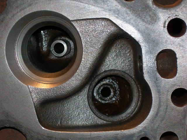

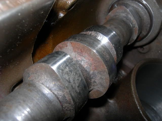

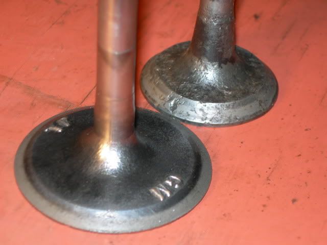

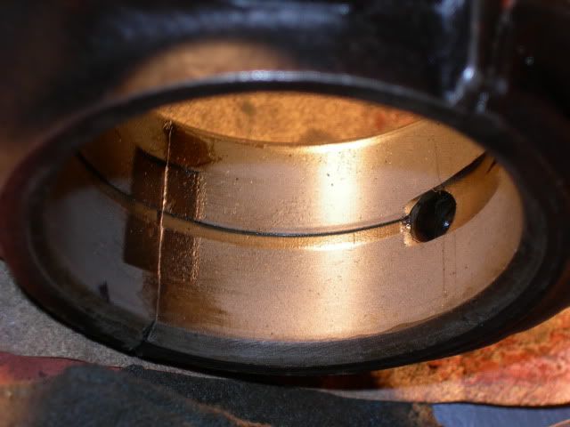

Since you like pics, here are a few more! I will continue to post pictures as the engine progresses, since there seems to be some interest.
You must realize that I am planning to haul dirt, drywall, and whatnot. I'm not planning to drive in a parade. If the engine runs acceptably as-is, to me it seems crazy to have it rebuilt. Of course I have no idea how it runs because it was seized when I bought it.
The assembly process so far has been thoroughly enjoyable. This is way more fun than dis-assembly and cleaning. My day is spent looking forward to spending time with the engine, and I find it interesting to see and understand how the engine works.
Rod bearing
Camshaft
Valve seat
Valves

I would strongly suggest locating a backup engine- - - -soon. The camshaft and cylinder head both have serious issues, ones which will have you going back into the engine before long. Also, read up on the proper way to check and adjust the oil clearance on the connecting rods. It's a very critical part of the reassembly procedure on a splash-oiler engine. If you get six months of intermittent use out of that engine, that should be about all you can reasonably expect.

I'm disappointed to learn that. I am probably responsible for some of the corrosion - the engine has been sitting disassembled for perhaps 8 years.
On the bright side, it sounds like I can expect this to run!
