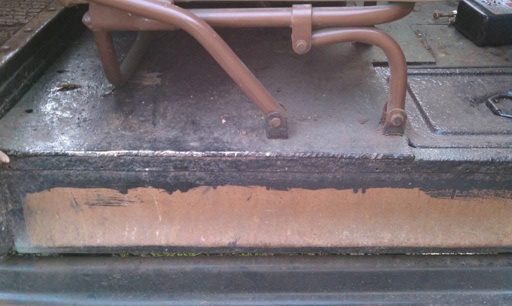

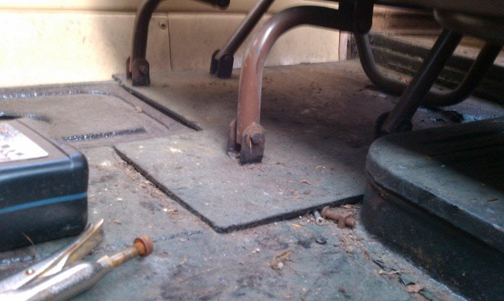

Does anybody remake these or know where i can get a set im sure it woudl be to hard to make but if i coudl findthem already made or nice set of OG ones id buy them please let me know thanks
http://i89.photobucket.com/albums/k237/bigtony55/IMAG0193.jpg
http://i89.photobucket.com/albums/k237/bigtony55/IMAG0194.jpg

This guy on E-bay has had these for sale for awhile now, looks pretty nice.

I would go with grade 8 bolts to mount not the stainless he mentions in the aution...........

For $110 I think I"d go to Lowes and buy some 3/4 flat steel and bend my own in a vise!!
...and stop at Ace Hardware on the way home for the bolts washers and pins!
Exactly what i was thinking

Never said it was a great deal. But it is a good deal. If you think you can properly form those brackets with just a bench vice your sadly mistaken. Better practice with some junk metal first.

I did mine with a shop press, that works much better. I tried the vice at first and they looked bad. With the press they are exactly like originals.You do need to find a piece of steel the correct width to place in the middle as you are pressing, I don't recall the width though.

just remember they also take a pivot pin.....then a 1/4 inch bolt.

If there is enough of a demand ( like around 10 people). I will fabricate them for everyone. I have fabricated them for mine and they look original. I can include them with hardware if you need me too.
