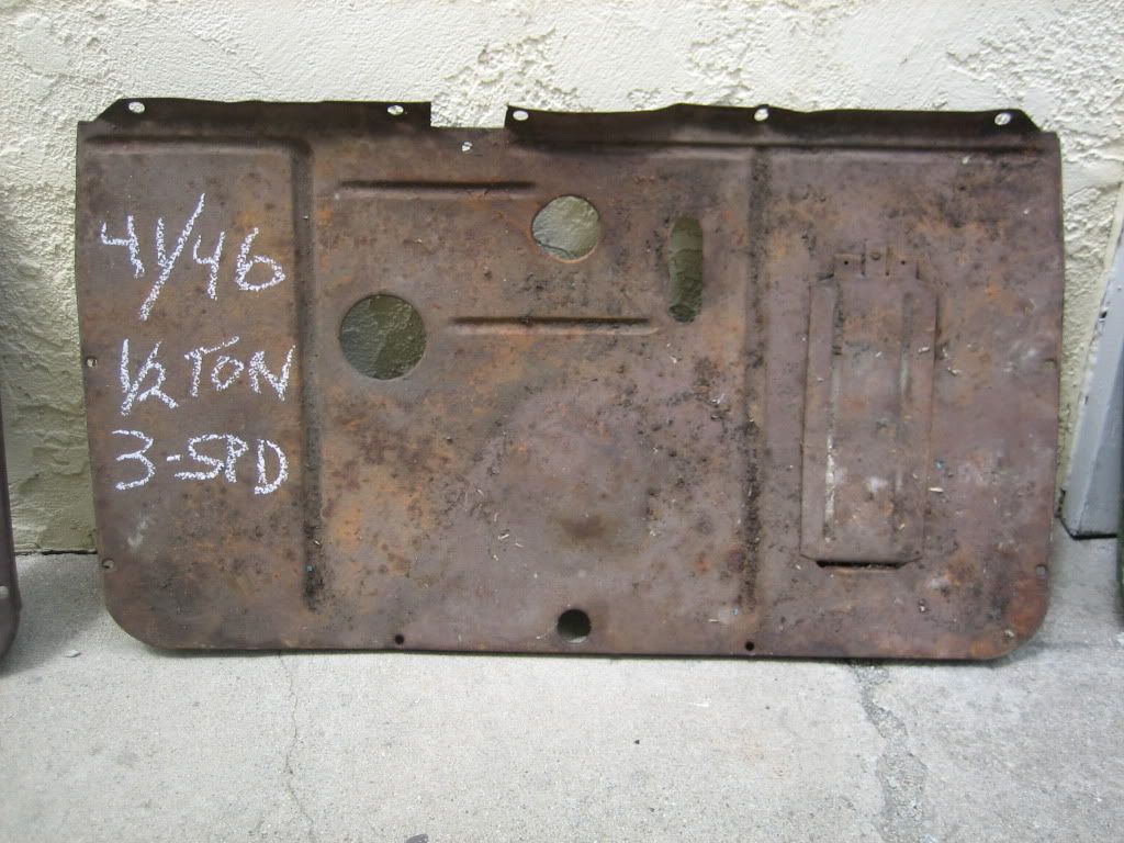

1941-1946 1/2-ton 3 speed trans:
http://i391.photobucket.com/albums/oo352/46Canopy/IMG_0033.jpg

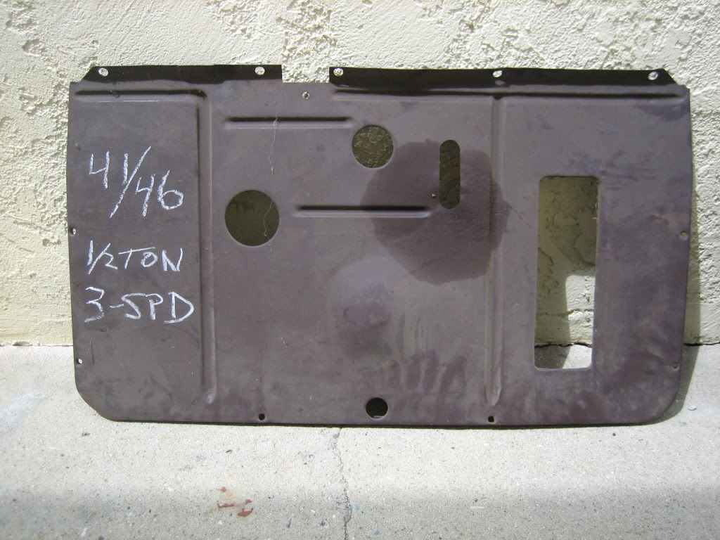

1941-1946 1/2-ton 3 speed trans, note batt cover with screw:
http://i391.photobucket.com/albums/oo352/46Canopy/IMG_0034.jpg

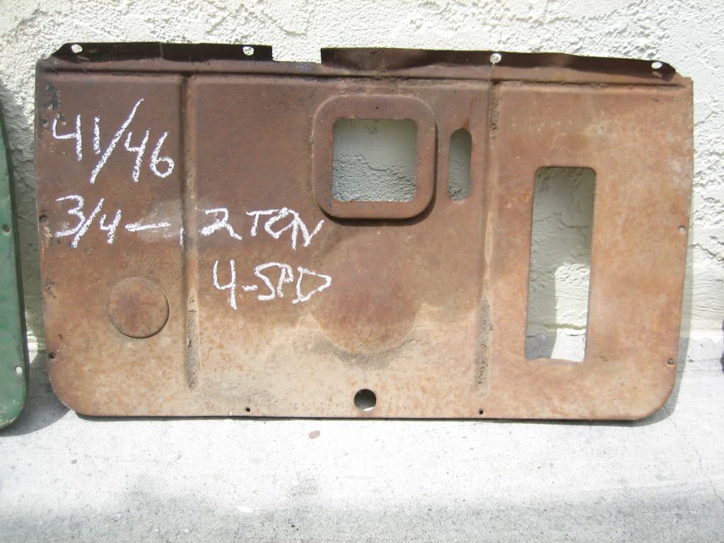

1941-1946 3/4-ton to 2-ton 4 speed:
http://i391.photobucket.com/albums/oo352/46Canopy/IMG_0036-1.jpg

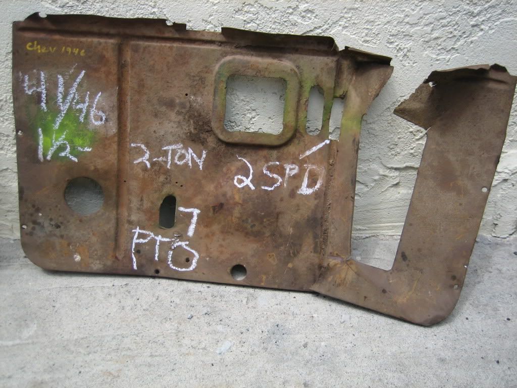

1941-1946 1-1/2 ton to 2-ton 4 speed with PTO and Manual 2 speed rear axle:
http://i391.photobucket.com/albums/oo352/46Canopy/IMG_0037.jpg
