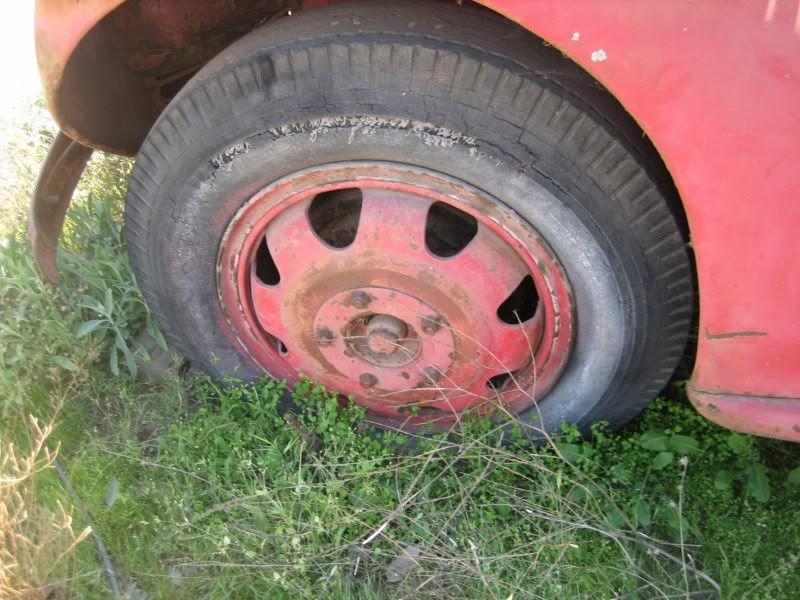

How does this rim come apart? There isnt a notch to stick the tire spoons in. It clearly has a lock ring, but I dont quite know how to get it off. Theres nothing special about this one. It looks like the stacks of others I have around the place, except its missing that notch. ohwell

is it a split wheel by chance ?

You will have to break the bead then drive the ring down. It will have an area that doesn't have a lip that you will be able to start working it off from. Those wheel get to be a PITA after they get rusty,

Hey Jeff, I have the same wheels that you have,.
I see what you mean about the notch missing. Is it possible that someone put on a lockring from a different wheel?

I agree with Scott,
Break the bead and push the ring down, then see what you have.
I see nothing wrong with it, and very doubtful you could interchange the wrong lock ring, at least not for long.. eek

Rusted nuts, the lock ring will not come off until you knock the tire down. You will either need a large tire hammer like this http://www.bigdogtoolz.com/kn35429.html or a slide hammer like this http://www.bigdogtoolz.com/kn35429.html I prefer a hammer. Put plenty of rubber lubricant such as Ruglyde or soapy water on the bead. Once you get the bead knocked down an inch or so, you can pry the lock ring off with one of these http://www.keenzo.com/showproduct.asp?M=KEN-TOOL&ID=1433144&ref=GB.

I have the tools, Ive just never ran into one without the notch.

Some of them don't have a notch. They have 2 gaps opposite of each other in the seating edge where you can pry them up. Once you knock the tire down, but will be able to see what I am talking about. After you pry the ring up, hit it with a hammer almost skimming the tire. It will jump off. I don't really like this kind of wheel. They are not as bad as the Firestone widow makers, but they are certainly not as good as other lock rings. I would sure put it in a cage during inflation. Our workers comp would have a fit if they saw me doing it, but I like to tap the lock ring when I am inflating it. The lock ring seats better.

There is a notch. Once you hammer the ring down a little & keep going around you will find it. The politically correct location is near the stem but it is not usually there.

Grigg - What mounting system do you think that is? Maybe an "AR" three piece. The kind with a solid side ring and real small split locking ring? With the paint it's hard to see whether the small ring is there. Motor Wheel would have used the same variety of outer rim designs as would Budd, K-H, or Firestone. I just can't think of anything that it would be other than an "AR". Stu

It's a single ring that has a certain way it comes a part. It's one of the more difficult wheels to service, especially after it starts showing it's age,

But I agree with Scott, The ring looks like a single one and a complete circle at that.

If it's a single ring it'll be the first I've come across that didn't have a tool notch. Please come back with more disassembled pics once you've got it apart. We're goin' to school here. Stu
