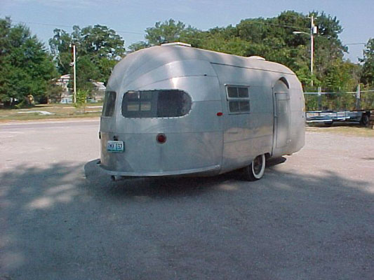

My late father-in-law had those Artillery wheels on his early '40 PU that I thought were neat. They would look good mounted on my Siver Streak travel trailer which I'll tow behind my '56 Burb next summer wink .
[img]http://www.tompatterson.com/Silverstreak/Pictures/195120ftclipper/04.jpg[/img]

Seon- The 15" artillery wheels were originally used on '37-'42 3/4-tons. They were wider (5-1/2") than the 16" wheels and used a tire that could carry a heavier load. In '46 the 3/4-tons became 8-bolt. I see there are some 15" artillery wheels for sale on ebay right now wink , so for some pictures just search ebay for "artillery wheel" or "Chev* artillery". By the way, the 15" artillery wheels are not cheap, a nice set of (4) sold for $900 last night on ebay.
Cool trailer! I have a 12' 1956 Terry that needs work.
