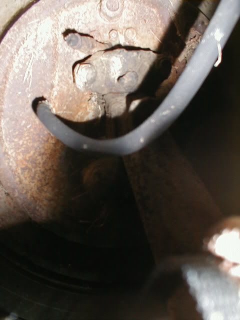

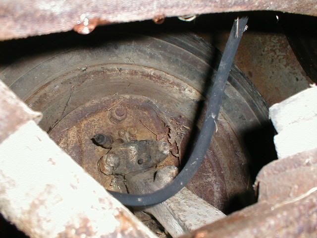

Look here and here. I was looking at the pictures and I think it confirms(hard to get a good look under there) that it is not a bleeder screw, but a bolt. Unless the bleeder screw is somehow in a different spot than the rear ones.

The one in the middle is the bleeder, the end of it has been broken off. Also looks like it's packed with either dirt or rust, maybe a mix of both.

JDL, when you try to take out the bleeder screws do not use and "open end" wrench. Use a "boxed end" and make sure its not worn out. That will help prevent rounding the head off...If it still doesn't want to budge clamp a pair of vice grips on it once you get it off the truck and it'll twist out...or off!!
Good luck, keep us posted.

If you have either a six point box end wrench or a six point socket that will fit your bleeder screws, you'll have a better chance of getting them out than with a 12 point wrench or socket.
