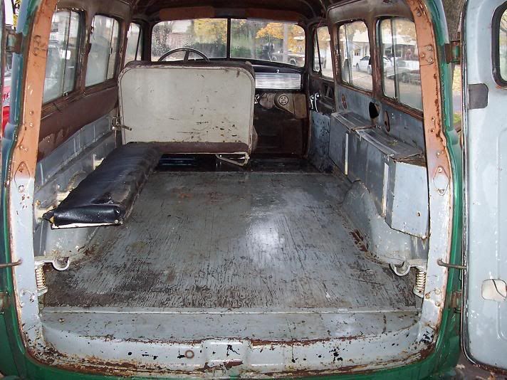

Heres the floor in my 53 GMC Burb before it was painted and redone inside.
http://i23.photobucket.com/albums/b372/1lowlesabre/000_0821.jpg
#246362 08/26/2007 5:37 AM
Joined: Oct 2003
Posts: 5,152
Joined: Oct 2003
Posts: 5,152
Interesting. I don't see the standard rear seat hold downs most suburbans have, nor the metal strips most panels have.
It looks like it was outfited to be a school bus or something similar when new. Do you know what the stuff above the rear wheel well on the passenger side might be? What are the two brackets just inside the door on either side?

Yea, it was am Army truck from the factory. The stuff on the passenger's side was for holding guns I guess? Or shuvles maybe....? The guy threw it all out though, AAAARRRRGGGG!!!!!!!
I don't know what those brakets by the rear doors are. this is how it looks now.
