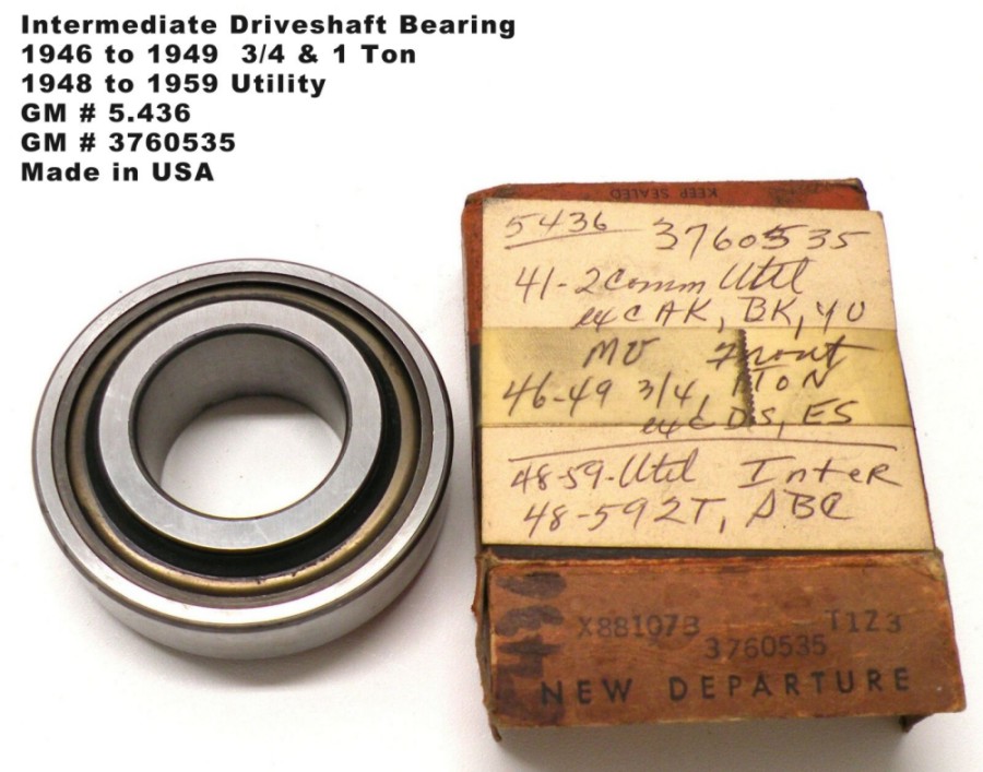

A while back there was discussion of carrier bearings for the 1-tons. I have gone through some of my papers searching for a wiring diagram and found a piece of paper from the box the carrier bearing came in. This one fits my truck perfectly. (1947 AD 3800, dually)
As information, see photo attached. - Joe
Neapco N212050X

Thanks Joe,
I have looked up that part number and specifications and I'm pretty sure it fits 3/4 through 2 ton AD trucks, and likely more years that I'm not familiar with.
This is the rubber bushing, bearing, and shields to rebuild the original carrier bearing/hanger.
As seen in the shop manual here, and rebuild instructions:
http://chevy.oldcarmanualproject.com/shop/1948_51truck/51ctsm0456.htm
"propeller shaft bearing support"

Here's some photos of GM NOS intermediate driveshaft parts .
Both are available on ebay . Go to ebay & in the search box type the part # .
PICS
https://i.postimg.cc/7Z8z0Tf5/GM-3657524.jpg
https://i.postimg.cc/JhRBdV3m/GM-3760535.jpg
They fit 1954 1 ton & 1954 3/4 ton .

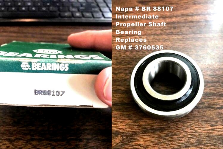

After market napa bearing .
https://i.postimg.cc/cLtT498f/new-1-b.jpg
