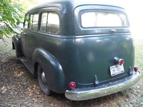

I have a rust free 1950 Suburban shell that is sitting on a frame. Previous owner put new front floor panel in without seat riser. Missing all seats. Trying to decide whether to locate and install original factory seat set or, modern seats that would tilt forward for access.
Thoughts appreciated to help me decide what direction to take .
