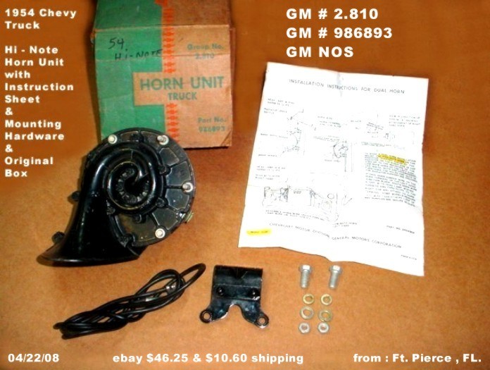

Here's a GM NOS horn I bought for my 1954 Chevy 3600 back in 2008 .
PIC
https://i.postimg.cc/PxJzFKZT/Hi-Note-Horn-Kit-NOS-b.jpg
https://i.postimg.cc/0ygQ77LH/Horn-Instruction-Sheet.jpg

My latest 50 3600 had 2 trumpet horns mounted on the passenger side of the firewall above the heater control valve. One was about 10" long and the other about 12" long. They were mounted side-by-side on 1 bracket. Each horn was insulated from the bracket. There was a relay mounted close to them. I removed them since I couldn't get them to work. I wish I had a picture. I don't know if they were aftermarket or a dealer installed accessory.
Professional Novice
Posts: 3,596
Posts: 3,596
These were most likely Town & Country horns, these were available as an accessory from the 1930’s through the late ‘50s.
https://www.flickr.com/photos/advance-design_parts_co/44842918801/in/album-72157631868452754/
These were available from Delco/GM as well as a host of aftermarket suppliers.
https://www.flickr.com/photos/advance-design_parts_co/33240486418/in/album-72157631868452754/
Big bracket, big horns, they take up a lot of room. If you look at the switch you will understand the Town & Country reference.
These exact same horns appear in the 1946 Salesman Data Book, they are common on the piano hood cars and trucks, the alligator hoods much less so, the photo below shows how much room is consumed (non-factory).
https://www.flickr.com/photos/advance-design_parts_co/30831498501/in/album-72157631870734114/

More photo references, 1951 set, the bracket are attached to the horns, they attach to the cad brackets shown. As discussed earlier wiring was made in exact, complete lengths.
https://www.flickr.com/photos/advance-design_parts_co/8129454392/in/album-72157631868452754/
Detail on the H (high) low marking on horns. High is always the optional horn if single set.
https://www.flickr.com/photos/advance-design_parts_co/14150816938/in/album-72157631868452754/
Typical dual horn install kit, all parts, pieces, directions furnished.
https://www.flickr.com/photos/advance-design_parts_co/15492567825/in/album-72157631868452754/
GMC NOS version (very rare as are most GMC accessories).
https://www.flickr.com/photos/advance-design_parts_co/16058087333/in/album-72157631868452754/
A set installed on a COE, pretty tight!
https://www.flickr.com/photos/advance-design_parts_co/28601771951/in/album-72157631870734114/
Pre-1954 vintage kit, identified by cloth wire.
https://www.flickr.com/photos/advance-design_parts_co/44122206874/in/album-72157631868452754/
1953 Accessory Guide showing single horn.
https://www.flickr.com/photos/advance-design_parts_co/23903473532/in/album-72157631872034068/
1954 Accessory Guide showing single horn.
https://www.flickr.com/photos/advance-design_parts_co/29345261632/in/album-72157631872034068/
