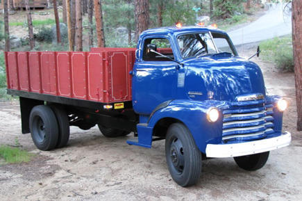

On all three trucks, there were prior restoration issues that annoyed me. This got me to thinking of trying to do a frame off restoration myself. If I was going to do that, I wanted it to be a truck that I really liked, and that happened to be the Chevrolet Advance Design Cab Over Engine (COE) trucks.
Now you have to understand, I have little mechanical experience, as my day job is a desk jockey (I spend my days peering through a microscope as a Pathologist). I have gained experience repairing my other trucks, which gave me the confidence to attempt a complete restoration. I think I have always had some natural mechanical skills, but little experience.  My first truck was the '42 and I paid a shop to get it going.  My last truck, this 1950 COE, I did a total frame off restoration myself (with some help, here and there). Stovebolt.com was a consistent resource.
So finding a good truck for this project took some doing. I had been looking for an AD cabover and it was a while to find a suitable candidate. I found this one in Minnesota, just east of Fargo, North Dakota and exactly 1800 miles from my place in Arizona. It was a 1950 5700 with a grain body and hoist. The truck was pretty complete; an important consideration with these trucks. Many of the cab parts interchange with the ordinary trucks, so reproduction parts are available. Certain things, like the doors, hood, grab handles, floorboards and fenders are unique. It ran good enough to move around the yard and even the hoist worked.

While I was studying the COE and contemplating restoring one, I wanted to know how tall they were. My shop in Prescott has 8 foot doors and I wanted to know if it would fit.
I was at an ATHS show in Colorado Springs and one guy let me measure the height of his COE. I researched factory information and I determined the truck was one inch shy of 8 feet so it would fit.
When I arrived home from my trip, I discovered that I forgot about the cab marker lights on top and it wouldn't fit!! You have to have the marker lights, as that is part of the truck personality. So, I called my friend who built my shop and despite his protests, I convinced him to help me raise the header on the door, modify the garage door, and raise it 6 inches.
You will notice the truck used to be black and I am more partial to blue, so I decided to repaint it in Mariner Blue, a correct color for that year truck. I really wanted this truck to be stock.
I also restored the bed, using reclaimed telephone poles out of the Arizona desert, which provided very dry and stable wood. It has a hydraulic lift, so this truck could actually go to work.
I started working part time about six years ago, giving me time to attempt the restoration of the COE. The truck restoration took four years. He has already been in the Prescott, AZ Christmas Parade. Since he has to earn his keep, I anticipate he will make a few runs to the local dump also.
My wife named the truck Barney (for Barnesville, MN where the truck came from). The photos in the link above include a shot in Colorado Springs with Pikes Peak in the background and my place near Prescott AZ, with stable mates (the 1942 Chevy pickup and the 1947 Diamond T, model 509).
