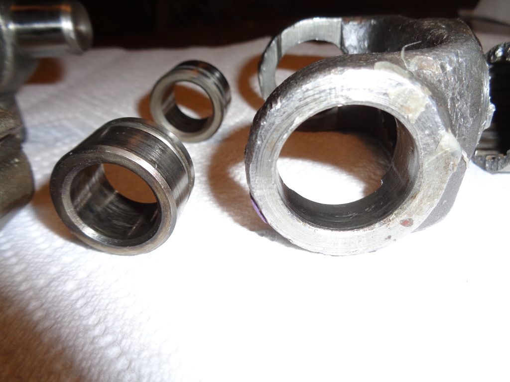

I have a 1950 3100 With a 3 speed. I bought a u/joint from the Filling Station (fs-101) the replacement joint has needle bearings where as the original just used bushings. I didnt see a problem with the needle bearings so I went ahead and tried to install it. The problem I'm having is the caps that bolt to the yoke on the transmission will not seat all the way into the yoke. The bearing caps aren't machined like the originals. Has anyone else run into a problem like this when replacing their u/joint?
http://i1209.photobucket.com/albums/cc399/bicounty/746b93261d7df4206d0210f7a069534a.jpg
http://i1209.photobucket.com/albums/cc399/bicounty/cfbbeea640c84d5ab37cfacb2f535e00.jpg

I would worry more about keeping those needles in place; many (let's say 75% as a high estimate ) replacement parts that are manufactured for these trucks do not fit exactly as the part they are replacing. I'm a new guy to these trucks myself, but what you've got pictured looks like it will function just fine.

That is seated correctly, they were not intended to touch all the way around. Just on the mounting flange and on the first 1/8" on each side.
In looking at your pic. again it looks like it is not touching on the mounting flange on one side.
It looks like it has not been machined with the flat sides to drop in place.

I replaced the U-Joint in my late '49 1/2 ton Chevrolet Truck. I got mine from Classic Chevy Truck Parts. NO NEEDLE BEARINGS! It came with the bushings. I'm with Uncle Brad and Pre'68 Dave, it looks seated correctly, but I would definitely be concerned about those needle bearings and staying in place. The front u-joint moves side to side just a little bit, but I would be concerned about the needle bearings slipping out or breaking and working there way into the transmission output bearing. If it were me, I would get the U-Joint with the bushings like the original. Just a suggestion.

I agree with the gentlemen above. The only thing I do not see is the clip to install under the bolt to prevent the bolt from backing out over time. You need to make sure this is installed or somewhere down the road a loud noise awaits.......

It will be impossible to file-fit the new part- - - -it's hardened. It might be possible to file or grind just a little off the corner of the yoke without compromising the strength of anything, but I'll add my voice to the chorus of "use the bushing"!

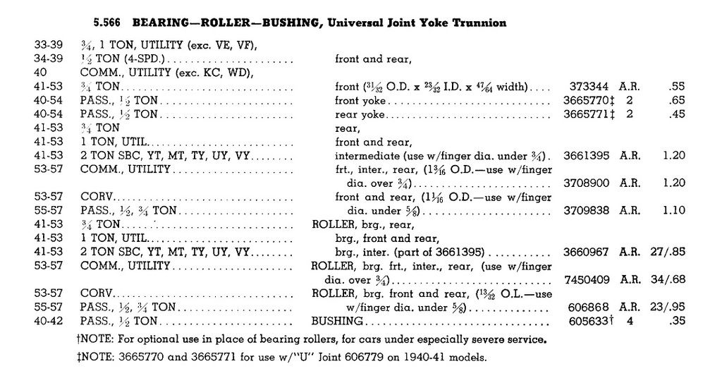

It says in MPC that you can use, needle bearing, bushing or Granodized type. (read Note under rear yoke)
Just as long all 4 are the same.
Bearing, Roller, Bushing - Group # 5.566 I'm assuming roller means (needle bearing)
373344 eBay - Type ???
Is Granodized the same as "oilite" ?
How do you know if you have a Bushing or Granodized type?

Roller would be needle brg. If you note all of those are for
the open universal joints. that is the rear or intermediate
in the case of the half enclosed drive lines.
Granodized is a GM term. Have never found a description of it
from any GM literature but here is quote of Gene's
interpritation of it from over at the VCCA:
"graanodized refers to a coating. I would bet it is like the
tin Chevrolet plated the cast iron pistons with from 1935 and
up. Luthy brand piston rings advertised that they were granodized
to assist break-in. Have see n it mentioned as being used on
other parts also.
The granodizing looks like a black powder coating. In the high
friction areas it wears away and helps to form a super smooth
wearing surface."
I would imagine that it was a process for thermal or flame
spray coating a material on the surface of a part or it
might have been an early type of thin graphite coating.
Your ebay listing is just showing a set of plain type
bearing caps, which appear to be steel. I'm not familiar
with the pre-WWII vehicles, but judging from the parts book
I would imagine that some were still using the plain
bearing caps even though the roller bearing caps were
in use on some vehicles.

MPC stands for "Master Parts Catalog" Don't feel bad, when I 1st saw MPC I was stumped for a couple days.
U-Joint Illustration link from 1929 - 1957 Chevrolet Master Parts & Accessories Catalog on http://chevy.oldcarmanualproject.com/ Website.
The text on the page from chevy.oldcarmanualproject.com was not very clear so went to
This Page and This Page ---on--- http://www.gmpartswiki.com/browse and screen shot a close up and uploaded on my Photobucket Album.
The reason: www.gmpartswiki.com/browse is not very quick at loading pages sometimes, but the text is sometimes clearer.
DG, I think MPC refers to the Master Parts Catalog.
Correct.
I would say This picture (scroll down) of the u-joint assembly shows the bushing type bearing.
Read under "Universal Joint" It says 'using bushings in place of needle bearings'
I think most of the bearings I have seen were of the Granodized Type.

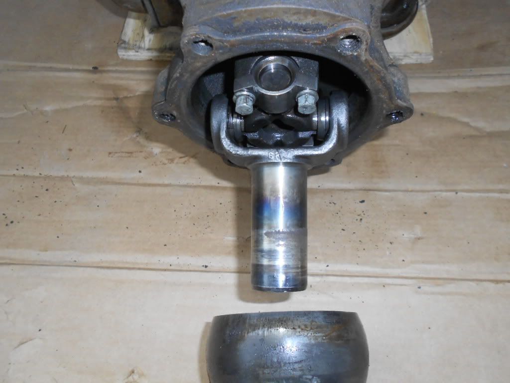

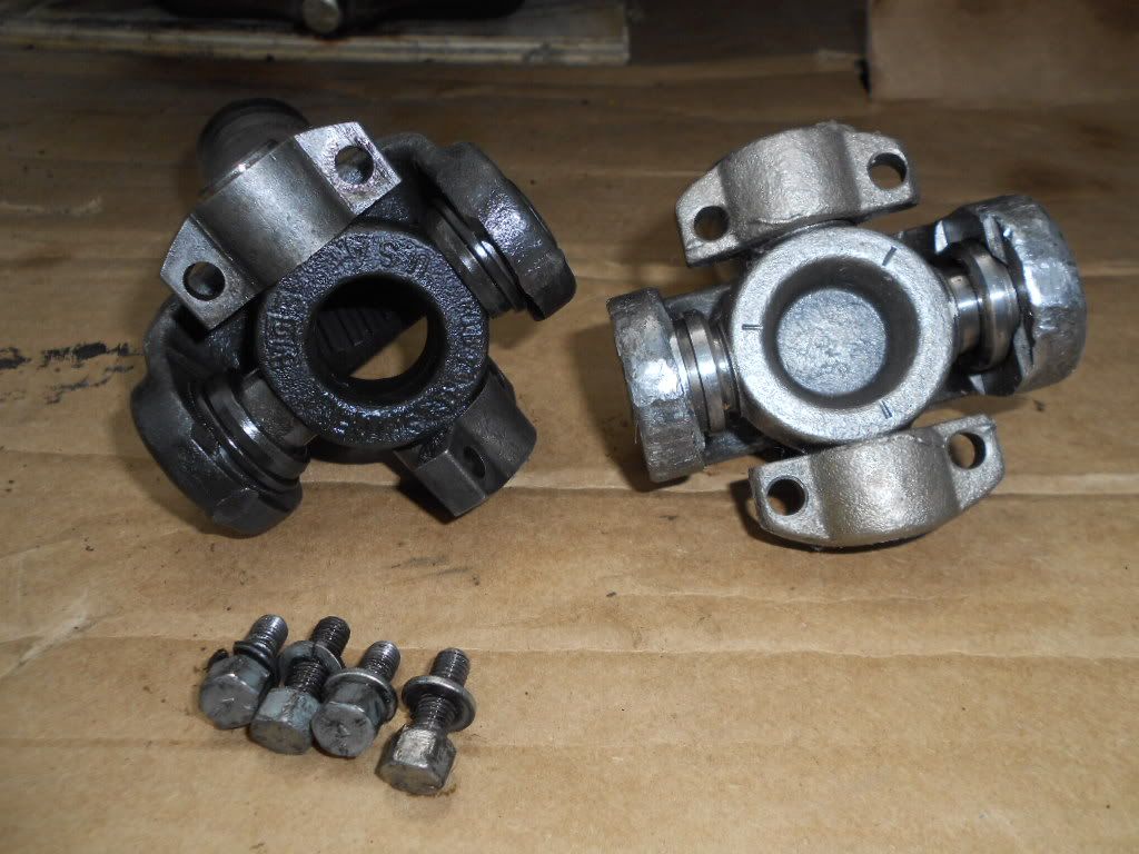

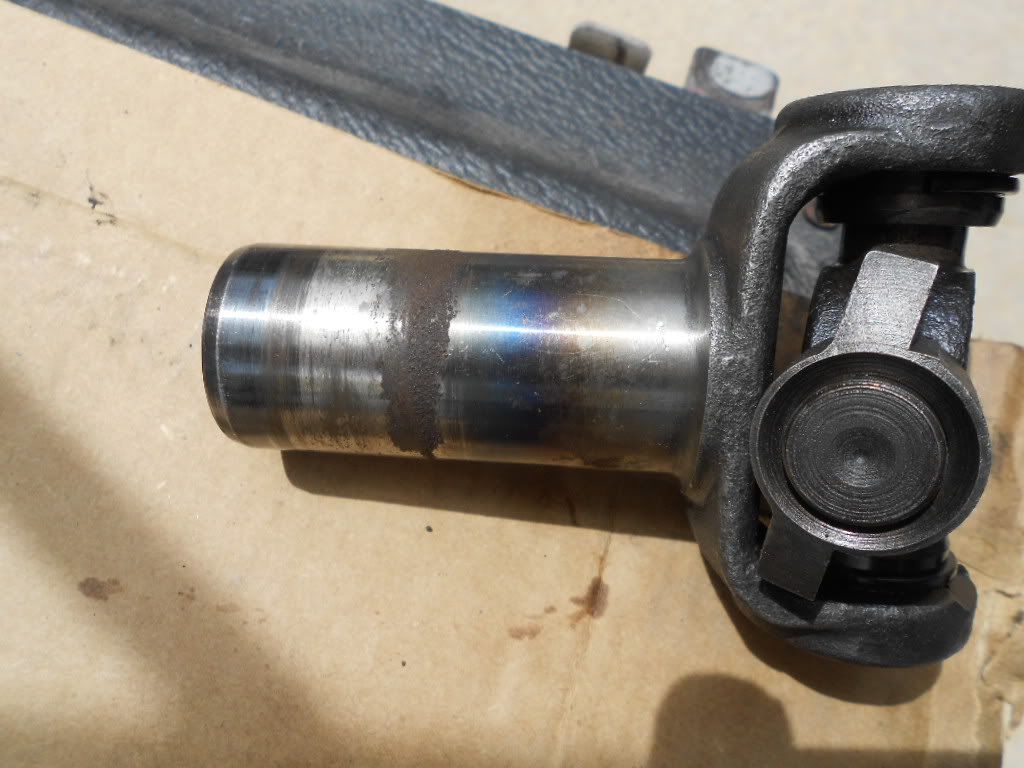

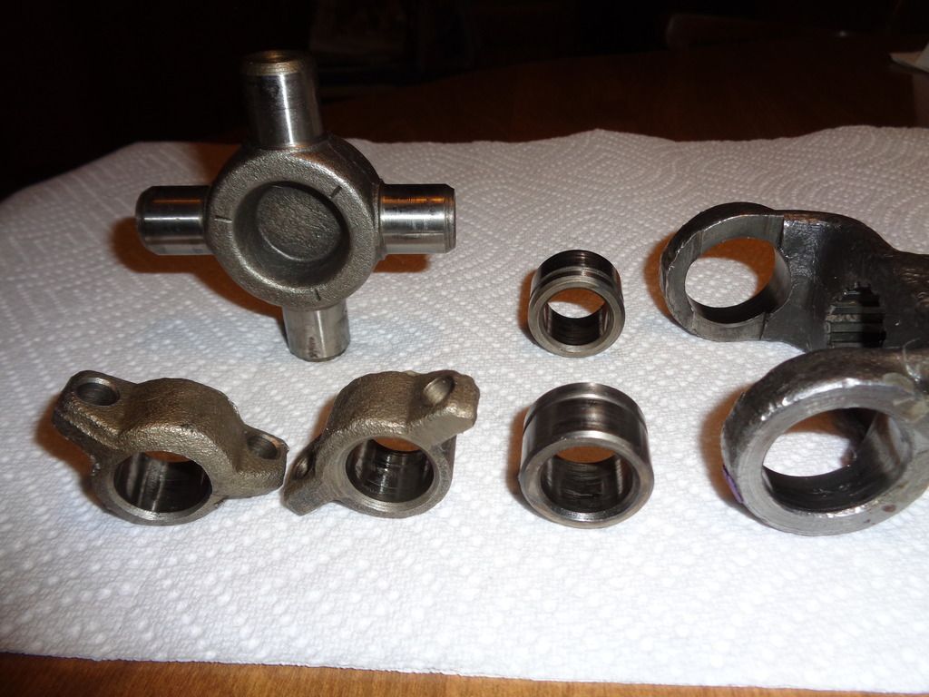

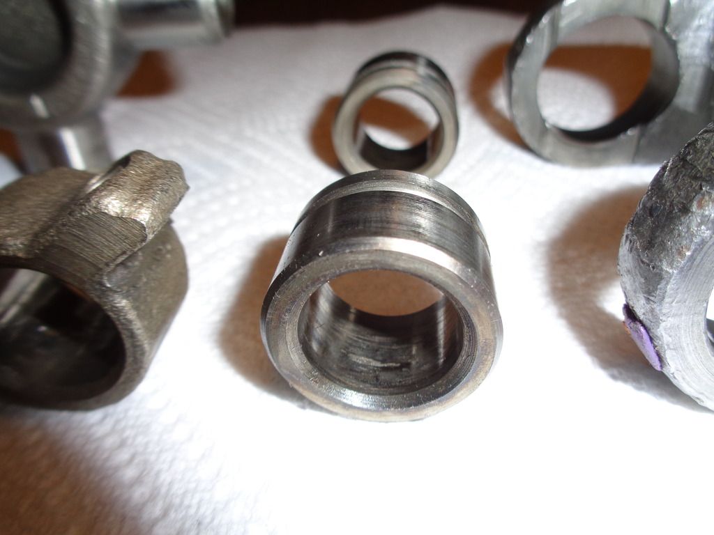

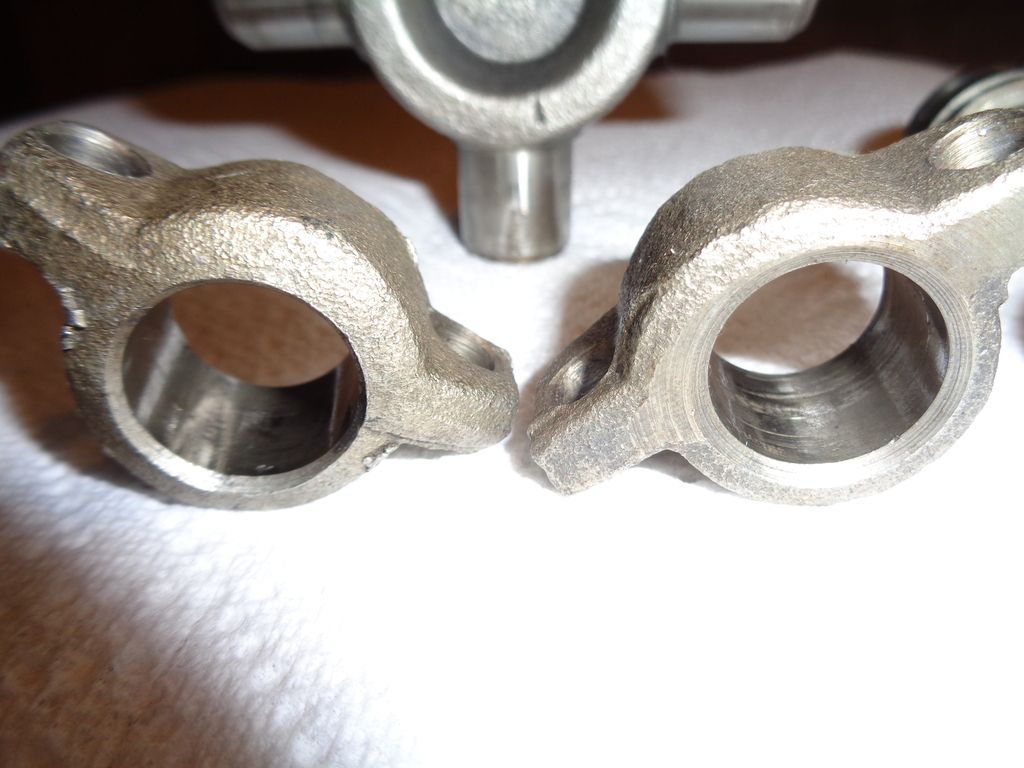

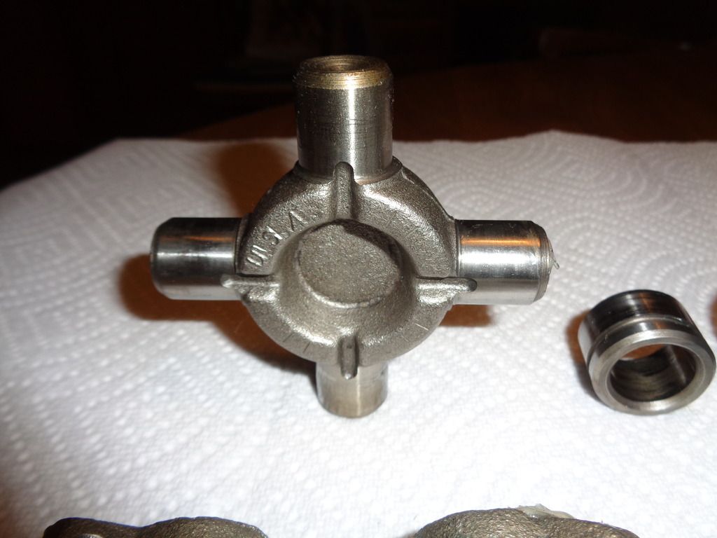

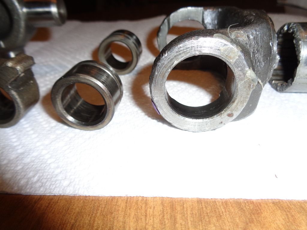

Here are some pictures of a disassembled 1954 Chevrolet 1/2 ton U-Joint.
The bearings used I believe are of the Granodized type.
Pic A
Pic B
Pic C
Pic D
Pic E
Pic F
Pic G
Pic H
What is interesting the rear yoke bearing (ring) not only moves on the trunnion surface, but also on the rear yoke hole surface.
On both sides of the bearing there is movement.
Unless the lock ring keep the bearing from moving inside the rear yoke hole.
Isn't the rear bearing suppose to be pressed into the rear yoke hole with no movement? (tight fit)
On the front yoke bearing (winged) there is only movement on the trunnion surface and inside surface of the bearing.
The other side is fixed and bolted to the front yoke.

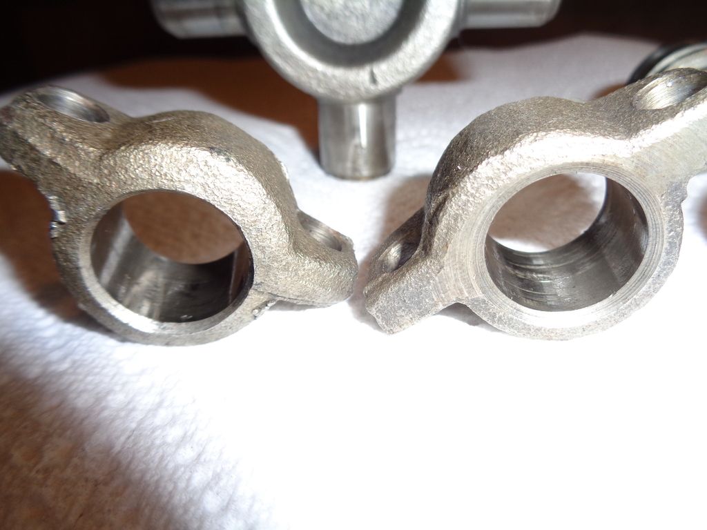

In my effort to make everything as perfect as possible I ordered another u joint fron Classic. The new joint is cheap Chinese crap. Why do I even try. I'm going to use the original joint. If you look at the original cap you will see a flat line machined at the base of the arch. The transmission yoke has the same flat line machined into it. They kind of lock into each other. You can see the crappy looking casting on the replacement cap.
http://s1209.photobucket.com/user/bicounty/media/E136F16D-7B8E-4A66-B194-DB76054861F6.jpg.html
http://s1209.photobucket.com/user/bicounty/media/90916376-DAA0-4BA9-A50C-4ECC44DA5E97.jpg.html
