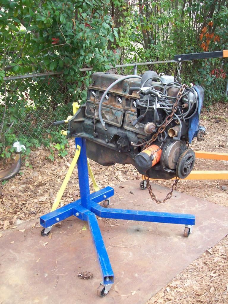

I've read some old threads that talk about how topple-prone stovebolt are on a stand. This looks better than those three leg things, but need some advice. Rated for 750 lbs and listed on CL.

It appears to be patterned after this one.
http://www.amazon.com/OTC-1726A-Capacity-Engine-Stand/dp/B002YKTW4O
They are much more stable than the 3 leg things.
I use one of these.
http://www.amazon.com/OTC-1735B-Heavy-Duty-Motor-Rotor-Repair/dp/B00ILVNOG2
It was designed to grab engines from the side and it works very well on my Y-Blocks. When I do a GMC, I bolt on to the back of the motor as well as the front. I think an adapter for the front can be built for the one you are looking at. It is really nice working on an engine that is supported on either 2 sides or both ends.

Think it will be safe enough to use?

JW51, while I don't specifically like it, I am currently using a 3 wheel engine stand. Currently I have a 283 on one stand and a 261 6cyl. engine on another. It is however not one of the "cheap" ones. Its a heavier duty one than most sold at discount houses today.
Just be/think safe no matter what you use.

Safety is very important. The longer the engine block, the easier it will be for a 3 wheel stand to flip over. I prefer 4 wheels.
Looks like the one in your pic is rated at 750lbs.
I bought this engine stand about 8 years ago for $40 on CL. The only "problem" I have with it is trying to get cherry picker in close. The wide spread of the lower legs make it a little tough for the cherry picker to straddle them.

JW51 Depending on how much they are asking for I would snag this one...
http://www.harborfreight.com/1000-lb-capacity-engine-stand-69520.html
I just picked one up and if you aren't already on their text list you get a 20% off coupon.
Put it together in about 20 minutes and it is currently holding a promising sbc 350 candidate at the moment.

It has been posted many times that the stovebolt engine is a long and relatively heavy engine, you will have to be very careful when rolling an engine around in one of those 750lb or 1000lb stands. I have one that I do not move, and I gave one away.
This stand is sturdier and much more stable. It is safe and easy for rolling around and for rotating an engine. I do not remember ever having problems using a shop crane to move a engine onto and off of this stand.
If you are careful and if you do not plan to roll the engine much/often, those lighter stands might be OK. Move the engine by pulling from/on the front of the engine and be very careful when turning.

I had just bought this 2000lb stand last week wanted the sturdy unit to hold my 235. I have a nice NAPA stand that has done well for V8s, but just not in favor of it for a long I6.
Make sure to snag a 20% off coupon and it gets the price down to about $112 (depending on tax). I keep three or four on hand always.
The only thing left to add to it is DEVE's engine plate, making a real sweet rig.

Get the one Tim mentions. Its the one I have and am very very happy with it. Some stands, the engine bobs around while rolling it. This one is rock stable. You get the idea. smile
Also, look carefully at this pic and notice how much wider I made the wings than the bellhousing. Its important to the design for it to be wider. (the line drawn with sharpie)
http://devestechnet.com/Images/Projects/Project1959235/Project59235333lg.jpg

I read through the responses quickly and I don't know for sure if anyone answered your original post! I would use that stand, IF the wheels were not buggered up, and then would use two people to move the engine short distances on level, good quality, smooth cement. When going over the purchase flip the stand to its side and check the wheels, if unoiled or balky, ask the guy for some oil and see if the bearings are shot. If you had to buy good quality wheels that would be $40 or so, might as well go with one of the new ones suggested. If ok in the bearing dept look at all the welds carefully, any re welds, poor welds walk away even if he's selling for a song. I like that lower gusset, could be a higher quality stand.
I bought a used heavier duty stand and the mounting area was really buggered up, our own Grigg spent a
good hour making it right, btw he's a certified machinist.
My lesson is check new OR used carefully.
