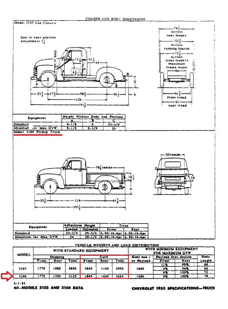

To complicate things, I'm assuming that the rating for the jack stands is for each stand. So for my original 3 ton jack stands, this is less than 100% margin each. So...I bought a pair of 6 ton ratcheting (with locking pin) jack stands. This gives me 368% margin on each stand, when using the total truck weight for calculating. I know each stand does not support the weight of the entire truck, but don't know a way to figure out what load it is actually carrying.
So what I'm thinking...using the 6 ton stands on the front and the 3 ton stands on the rear, until I can replace the 3's with 6's. Sound ok or am I looking at being added to the Darwin list in 2015?

There should be a rating tag on the stand. It should indicate the weight/load limit per stand or per pair. 3 tons per stand would support 12.tons per four (on level ground). 3 tons per pair would support 6 tons - 12,000 lbs.
Either rating would allow safe use with your truck on solid, level ground.
I am not near my shop, so I cannot check the labels on my 3 ton and 6 ton HF stands. I use the 6 ton stands on my 2-ton GMC COE that has a 18 foot flat bed and dual rear wheels.
added later:
HF 3-ton = 6000 lbs evenly distributed over 2 stands (12,000 lbs evenly distributed over 4 stands).
