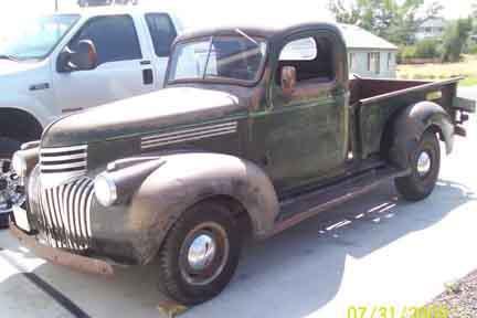

I purchased this the truck near Bend Oregon in 2009. My wife and I took a trip and looked at three trucks of the same vintage all in the same area. The price ranged from $2-3.5K. This one was the last one we looked at and by far the most complete. It was running when I bought it for $3K. It ran and was driven on to my car carrier.
I live in Brush Prairie WA just over the Columbia river from Portland OR.
We brought it home the following weekend and it sat for a year. The truck only had surface rust. Bend is high desert area. This truck had a title from Idaho last registered in the 1970's.
I am doing a body off restoration.
I dismantled the truck in the summer of 2010 and started the sand blasting and painting of all the chassis. The down-side to a truck that ran so long is many parts are very worn. This will be my daily driver to work when complete.
The engine is a 1953 block 216 with a three speed. I will keep the truck close to original. Replaced the rear diff gears with 3:55. The tranny is 3 speed and rebuilt now. The engine is being rebuilt in Portland and will have shell bearings instead of the poured in place babbit.
