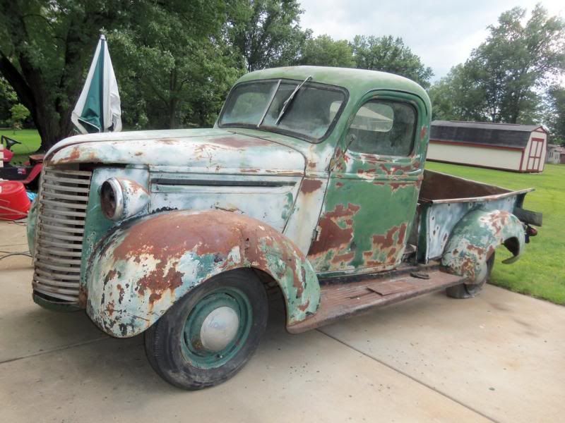

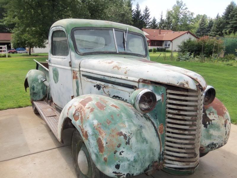

The truck I've mentioned in another thread or two has finally arrived.
It may not look like much, but... Yeah okay, it needs some work. But here's the gist.
It's pretty much just as I expected it. It's pretty rough around the edges, and I'm glad I'm planning on just tooling around in it for a while because it will be a real project to restore. But, again, it's sort of just what I wanted and I REALLY dig it. It's surprisingly complete and a lot of what's there is working, little things like the windows rolling up and down.

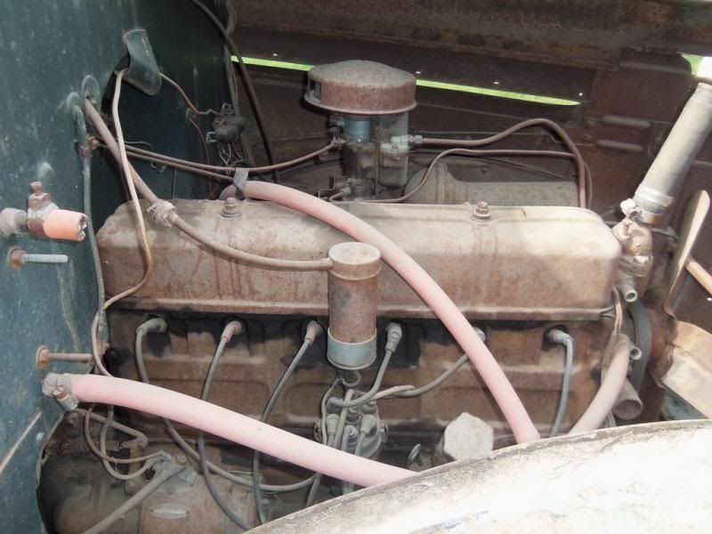

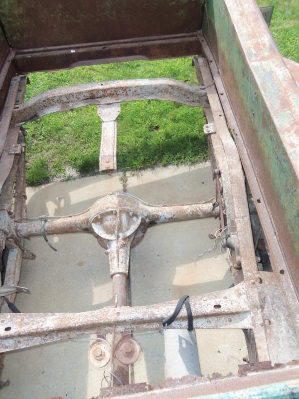

The rear end is frozen (probably locked brakes). The steering works good, the clutch works, the transmission shifts like it was brand new (it's kind of hilarious, actually). The worst thing I discovered is that the engine seems frozen, though. I didn't bust out any tools as I had to get moving shortly after it arrived, but a good tug on the belt seemed to do nothing. You can spin the fan easy but it's just hooked up to the water pump from the look of it. Maybe the crank will spin with some persuasion after all, but I'm not hopeful. It was advertised as having a free engine so I'm not too thrilled, needless to say. More on that soon.

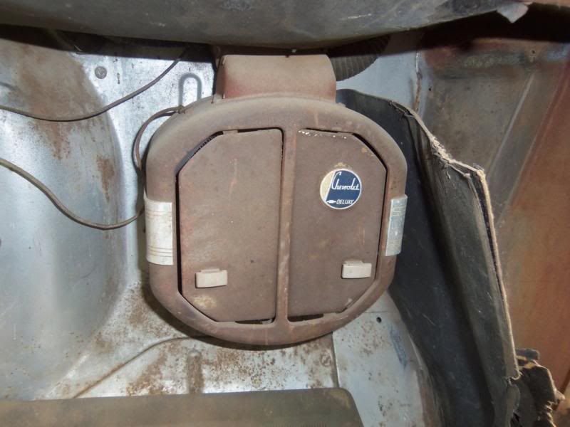

One really neat thing is that it has this cool old heater. I don't know if it was a dealer accessory or what, but it's marked Chevrolet Deluxe on it. Anyone shine some light on it?

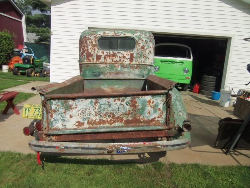

It obviously needs a complete bed floor. The bed is just sitting there at the moment.

That is the correct heater for a 39. I have the same one in my 39. Looks like most of the pieces are there. Great truck to work on.

Wow, no kidding. I figured these trucks would have had no heaters at all. Okay, cool.

I might add that with todays prices for body work it may be a good idea to look at Mar-K bed kits that come with all the stuff to have a new bed. Just a thought.

I've heard of the Mar-K bed floors, that's definitely on the wish list. Doesn't seem like you can beat their prices or quality.

You might try removing the sparkplugs on the engine and adding some Blaster or other rust penitrating oil in the cylinders and allow it to sit for a bit and see if it loosens up any.

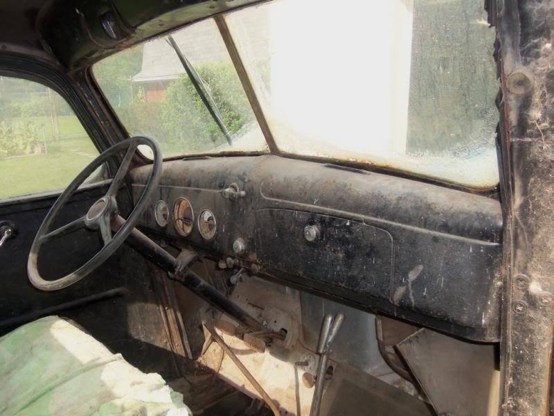

Thanks for all the support. I'll have to pick your brains about what all the controls are on the dash soon!

Thanks. I may not need it, though. It turns out the engine is free after all! There is one problem, though. There is one stuck valve. It is the 4th one from the front. The piston does not hit it, thankfully, but it's obviously still a problem. I'm sure it's just stuck in whatever position it had been sitting in. Any trick to getting it to hopefully pop loose? I drenched it in Blaster but I doubt that alone will make it loosen. Is heating it with a torch a good idea? It's under constant pressure from its spring so I was hoping it might just pop up when it's ready. Or, since it's apparently not all the way down (wouldn't the piston hit it if it was?) maybe I can tap on the end some with a rubber mallet?

tapping it sounds good to me.

After two day of messing with it I finally got both drums off the rear. Woot! The axle is totally fine and this baby rolls. I also had a used tire thrown on as the one was totally destroyed.
I also got the stuck valve more-or-less freed up. It opens and closes on its own now but seems to only open about 90%, but you can pry it up the rest of the way with a screwdriver. I figure if I go back and forth on it a while every day it will hopefully be good to go. I also think that if I get a battery in it and keep turning it over with the starter that consistent opening and closing will possibly get it to free up the rest of the way.

NYours looks like mine did (still does a little). Use marvel mystery oil in ur motor to free it up. By pass the gas tank with a gas can and a hose..Many ppl crank their engine using the original gas tank and suck all the garbage into ur motor for.more headaches.
A 4 foot piece.of fuel line is $4. Chevys of the forties can sell u a new coil..bypass ur electrical with a three pole switch.
u can pull the head to see whats hanging that valve. Id do that before whacking it with a hammer or prying on it.
I put autolite 303 sparkplugs in mine. And new plug wires. U can do all ur volkswagon restoration tricks on checking for spark
Check ur oil dipstick to see if she still has oil
