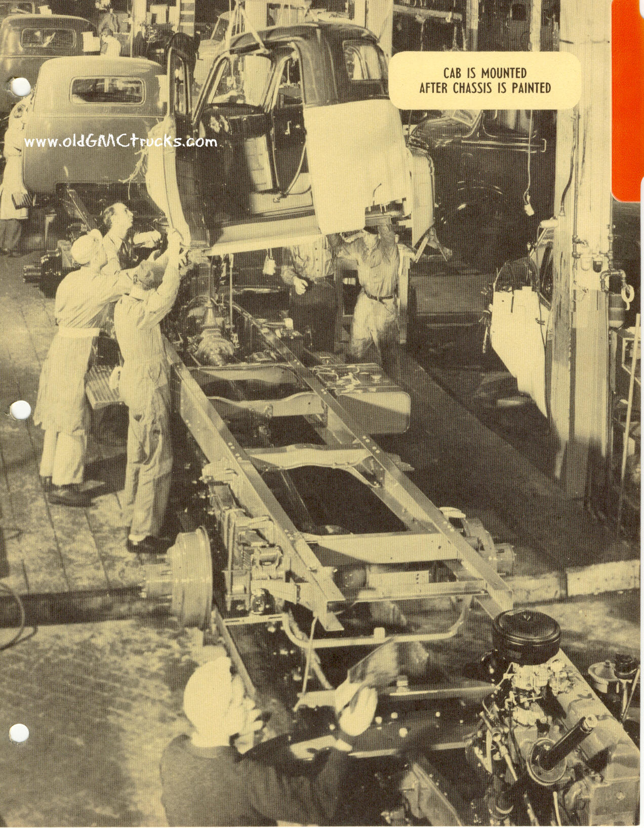

The holes in the cab at the top of the door opening are for lifting the cab on the assembly line.
Posts: 12,029
Posts: 12,029
if those holes are from assembly then there should be some kind of plug in them from the factory
Joined: Aug 2005
Posts: 1,186
Joined: Aug 2005
Posts: 1,186
I kinda agree with you Carl. It looks like a great place for one of their body jigs to lift the cab onto the chassis.

I dimly recall someone posting here a factory assembly photo showing the cab being held/lifted/lowered/installed onto the frame by an overhead assembly-line jig/hanger that used those hole above both door openings. And, as Greg noted above, I dimly recall finding a GM illustration of those holes not being plugged - they were described as being part of air-flow in the cab? I will continue looking for that information/illustration.
Here is the assembly line photo - it looks like those holes above the door are being used (that link was found in a post listed below)?
Here is an earlier post about those holes in the cab, above the doors.
Here is an earlier discussion.
None of this gives information about the holes being plugged or being unplugged as everyone has found them to be. Without documentation, I vote unplugged.

....and it was with interest in the first link Tim posted that there was a note saying..."cab is mounted after the chassis is painted". This was on the GMC.
...Tim, as always, thanks for your dedication.
