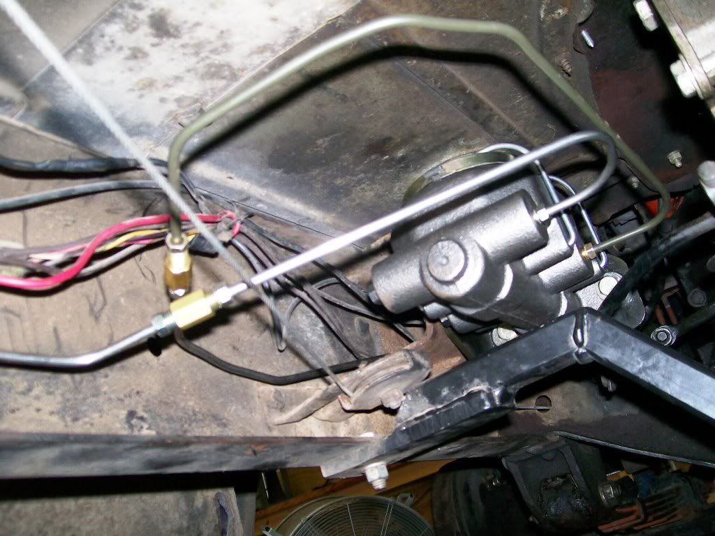

The brakes on my street rod continue to give me grief. I need to find the best way to bleed them once and for all.
The facts:
Under floor m/c with two stage (pancake) 7" booster.
Thru floor pedal
Corvette dual m/c (two large reservoirs), 1-1/8 bore
Corvette 11" disc front, '86 Camaro rear drums
2 pound residual valve front, 10 pound rear.
I lost the front brakes at the NSRA south show over last weekend from a failed rubber front left hose. Replaced the hose and attempting to bleed the front. I would like to be sure no air is left in the lines. This is always a problem as the rubber lines and maybe other parts are above the m/c.
I have a hand vacuum pump, an electric vacuum pump, self bleeders and normal bleed valves.
How would you do it?
Thanks

I guess I need to distill my question some. When one goes into their FAPS and gets a master cylinder there no instructions as to which reservoir is for front and rear (at least not that I have seen). I looked at the very good "MPB" web site for some insight. They show a number of master cylinder hook ups. You guess it, some pics show the front brakes going to the reservoir closest to the booster. Other pics show the reverse. When I bench bleed this m/c I closely watched which reservoir moved brake fluid first.
Another question is, which system is suppose to start braking first, front or rear?
Please remember, this is a street rod. You don't usually go into the auto parts store and ask for the parts by make and model then drop it in.
Thanks

You could trace your lines to find which is front and which is back on your "street rod" if you only want to bleed one side.
If it were me, and the brakes were working well before things went south, I'd assume they were routed correctly and bleed all of them.
I would bleed the entire circuit

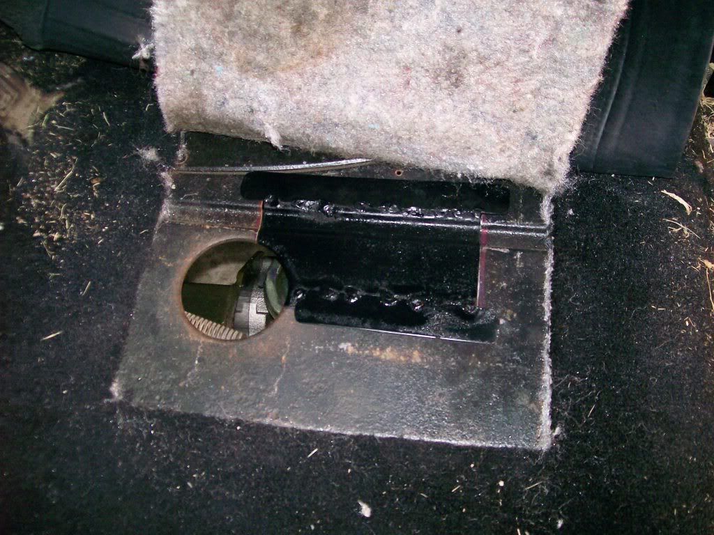

If you can’t access the MC, I would clean that up. You have to fill it eventually.
Motive pressure bleeder.
But that’s just me…
