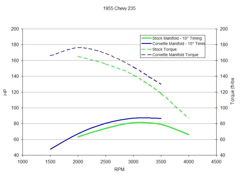

I achieved some modest gains with better exhaust on my 55.1 235.
It's stock except for a corvette exhaust manifold and dual exhaust with 22 inch Smithys.
dyno results
I picked up 11 lb-ft of torque at 2000 RPM, about a 6% gain,
and 6 HP at 3000 RPM, about a 7% gain.
