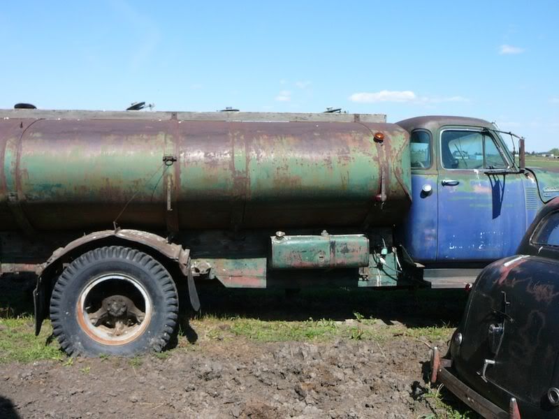

Hey all,
I'm looking at a heavy GMC truck. I'm new to the BIG trucks so I have two questions for the seasoned veterans / gurus.
1. Check out these wheels and tell me what their story is. Are they desirable or dangerous.
[IMG]http://i646.photobucket.com/albums/uu183/tazzeller/KGrHqZHJFEE-ko8eGBiBPwqGuZJ8Q48_20.jpg[/IMG]
[IMG]http://i646.photobucket.com/albums/uu183/tazzeller/KGrHqFHJCEE-lQT8EmTBPwqGqTLm48_20.jpg[/IMG]
2. Are the fenders on this truck extra wide or is it just the angle of the camera and my lack of experience that makes them look that way to me.
Unfortunately I have not seen the truck in person yet and am deciding my level of interest in a trip to go see it based on these pictures and the sellers description of it as a truck with an automatic that runs great.
Any information or opinions on this truck would be greatly appreciated.

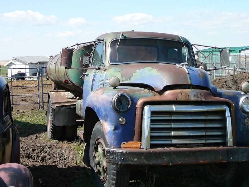

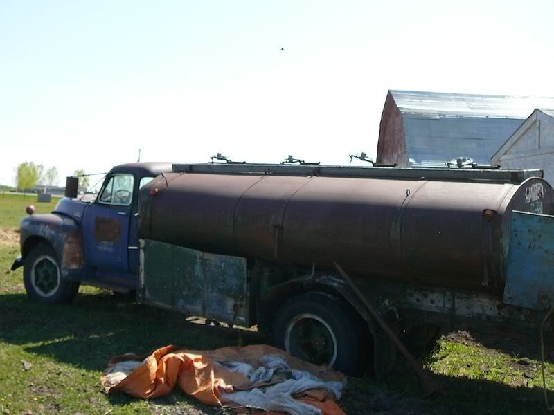

Hey,
Got two more pictures:
[IMG]http://i646.photobucket.com/albums/uu183/tazzeller/KGrHqRHJBIE-elF-K8gBPwqGlWwKw48_20.jpg[/IMG]
[IMG]http://i646.photobucket.com/albums/uu183/tazzeller/KGrHqJHJEUE-kFi6WZDBPwqGf8k9g48_20.jpg[/IMG]
I am not interested in a tanker body. Is this something I should be expect to be able to sell? Is it something that will turn into a nightmare to own due to environmental disposal concerns?
Again... any insights or opinions are welcomed.
Greg

A close-up of a front wheel would help. It looks like you have one of the "safer" wheel designs with a split outer ring, not the dangerous ones that come apart in the middle of the wheel. The bead ring will be facing toward the inside on the rear duals, so a close up shot of the rear wheel won't help identify the design. You've got the Dayton-style open-center wheels that will have a spacer ring between the rear duals. Different thickness spacers are available for different tread width tires to keep the sidewalls from touching each other.
The fenders and hood, and also the grill are wider on the 1 1/2 ton and bigger trucks to accomodate the larger diameter wheels and a wider track width on the heavier-capacity front axle.

Ok... I searched Dayton wheels as Jerry said. This seems to me to be what I have. I have never seen this style of wheel before this truck. Is this because this fuel truck is the largest / heaviest big bolt I have ever seen?
Also, if this is what I have... are these wheels desirable to have?
I'm hoping to get as much of a wheel education as I can before I look at the truck.
Finally... As Jerry said the fenders are larger on the 1 1/2 ton and up as compared to the 1/2 and 1 ton trucks. But are the fenders on this fuel truck even larger than the 1 1/2 ton trucks? I know the largest of the GMC COE trucks had wider fenders. Is this also true on trucks like this?
Keep the opinions coming
Greg

That's either a 400 series 2 1/2 ton, 450 series 3 ton, or 470 series 3 1/2 ton, with factory option Dayton wheels. I'd jump all over that one if I found it. The fenders on the 400, 450, & 470 series GMC trucks are larger than on the 300 series 1 1/2 ton, & 350 series 2 ton trucks. Also the 1954/'55 1st series "400" series trucks have two separate windshield wiper motors mounted above the windshield. And since the fenders are larger the '54/'55 "400" series trucks didn't use the square park lights, & fancy grille surround that the smaller trucks used. That truck should also have a 302ci. engine in it, if it's a 450, or 470 series.

I thought the front on this truck looked larger.
The farm it is on has had it for 'a couple of generations' and they aren't sure if they can find a registration for it (which may make it hard / impossible to register). I may buy it anyway and swap all the sheet metal over to another GMC I have a title for. If I go this route, will I end up stuck with the rolling chassis, or would there be any interest in these parts?

Spanky and Jerry know a lot more about these trucks than I do but I would think that is a fairly rare truck. Plus its all there and in good shape judging from the pictures. If it were me, I would keep it together, maybe ditch the fuel tank if that's not what you want but the rest of it leave as is. Can't you apply for a replacement title or register and antique with a bill of sale? Love the daytons too. There is nothing wrong with them.
Good find.

Bill, that is indeed a "Rare" truck. You don't find those "400" series trucks that often. In all the years that i've collected COE's, i've only ever found one 450, or 470 series GMC COE, on the East Coast. They always seem to show up out West, when they do show up. My 1952 470 series COE came out of Washington State.

If you want to get rid of the tanker body,you'll need to learn what was carried in it last,is there anything in it now,is it a leaker,etc. Once you know these things,you can decide whether to sell the tank to a rancher or Construction Co. (if it's solid and clean inside) or cut it up and scrap it (if it's not full of explosive vapors). If it was last used to haul fuel,it can still be flushed and ventilated enough to be safe to cut on.
As for the wheels,Daytons are a good set up;if you have 20" wheels,you can upgrade to 22",they fit the same hubs. Regarding the safety subject,I've never seen a "widowmaker" Dayton wheel,I don't think they exist. These wheels rely on a smooth rim center to slide over the hubs,so a center-split wheel couldn't work on a Dayton set up. I could be wrong...

I'm not sure about the laws in your country, but it would be difficult to dispose of here. It was born a 4 compartment gasoline tank wagon and it probably hauled leaded gasoline all of its useful life. I doubt that the axles from a the GMC would fit the Chev. The Hydra transmissions were rather common in tank wagons. If its working, it would be fine. If you have to go into it, it would be an expensive ordeal. The open centered wheels pictured are generically called Dayton. They were probably built by Erie or Webb because of the 6 spokes on the the steering axle. The dangerous Firestone RH5° were never built for open center hubs. The GMC would be an interesting project because I grew up in a tank wagon. But if you are interested in it for parts for the COE, I think you will have trouble with the steering axle. The drive axle can be easily be made to fit because both trucks use a 34" frame. The steering axle might work of you use 6" wide rims. That would gain you clearance on the inside. However if the tread is wider on the GMC axle, it would be a real challenge to keep the tires from rubbing the narrow fenders.

Some scrap yards won't take a fuel tank, however, since it is so nice-someone else is sure to want it for their original restoration. In general, it is sort of scary to torch a fuel tank, unless it is full of water first, a better idea is to find a friend w/ a cat to squish it flat, if one has to scrap a fuel tank. Nice truck, as Spanky said should have a 302, largest engine available in that series truck. Engine ser. no. is Stamped on a machined pad, starboard side, rear of engine behind distr., first 3 numbers are displ., i. e. 302xxxxx.
