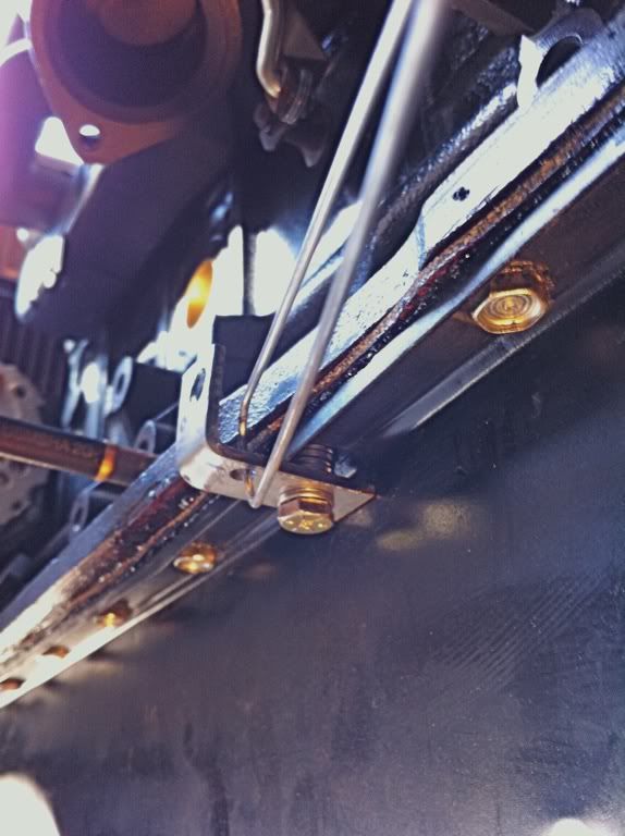

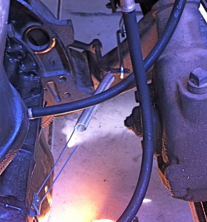

Thanks for the replies. Per your recommendations I made my own bracket. I think it turned out pretty good, even have a hole for the carburetor rod spring.
http://i1236.photobucket.com/albums/ff441/AZ59apacheguy/a4b8aecf.jpg
http://i1236.photobucket.com/albums/ff441/AZ59apacheguy/1b656965.jpg
http://i1236.photobucket.com/albums/ff441/AZ59apacheguy/87c0f7b7.jpg

If your referring to the clutch return spring bracket, I posted pics a couple of spot up. Or if your referring to the truck being done, I can't wait either :-)

I saw the bracket you made,looks nice.I was referring to seeing the truck when your done.That engine sure looks nice.

your bracket ended up just like mine - looks great. your spring looks like a generic hardware store spring... there is a replacement one available from the aftermarket.

Thanks for the reply. I actually bought that spring from truckandcarshop.com.
That's the spring they are selling as a replacement for the clutch return spring for '59. The one you posted looks more correct, i'll pick that one up the next time I place an order with them.
