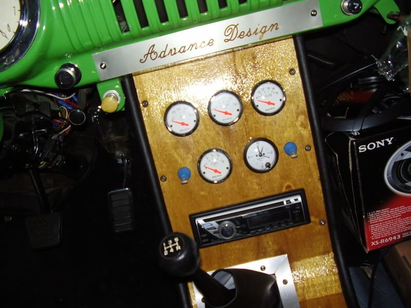

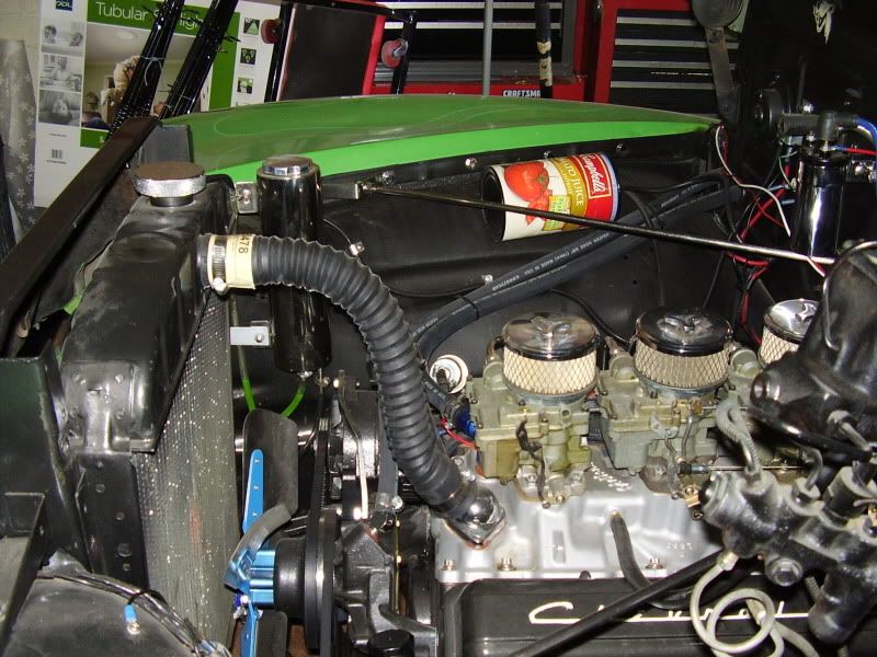

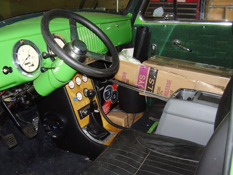

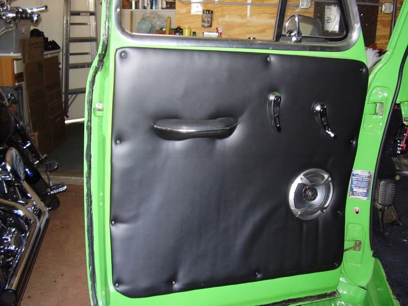

I know the purists will not like it..

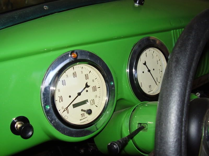

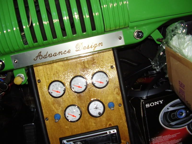

My 55 first series was modified when I got her. I decided to gut the interior. This included adding a rear gas tank.

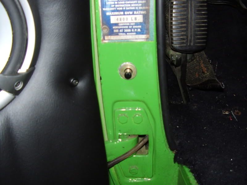

The dome light swich was fubared, so I wired it to a door jamb switches, also built a floor to dash console. Console has separate gauges stereo, speakers and courtesy lights, that work with the door jamb switches. LMC sells an interior courtesy light fader in which I incorporated. The two large holes where the gauges were, are now an Autometer Speedo and Tach. The speedo bezel is pre-drilled for LED turn signal and highbeam indicators.
What "out of the box" mods have you made to your ride?

How did you change your dome light to operate with door jamb switches? Originally it was switched-positive and the door jamb switches switch the ground.

Originally there were no door jamb switches. NAPA sells a universal door jamb switch, that works well. I just cross wired the switch to come on when a door opens, or I have a switch on the new console that turns it on. You are correct on the ground.
The radio delete modification you made is very interesting. I went to a trophy shop and had them make a size specific plate for the radio delete. I had the plate done in brushed aluminum and scripted with "Advance Design"

Project Helen - How did you insulate the dome light from the body so that it was not constantly grounded? I have thought about using nylon bolts.

To be honest I can't remember, seemed easy at the time.

Craig - it's the socket that's isolated from the light case, the original switch setup provides the ground direct to the socket

I would appreciate pictures of the center consol.
Will snap some today
