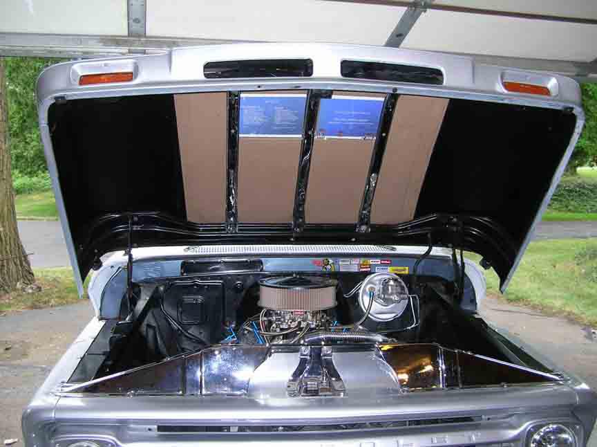

Here's an update. Take a look under the hood. And here are some of the details:
- 350 crate 4 bolt motor
- 75cc heads with Manley valves
- Comp cam and roller rockers
- MSD HEI ignition
- Edelbrock intake and carb
- Balanced but not blueprinted
- Cast ram horn exhaust
- Flowmasters thru the roll pan
- Aluminum radiator, water pump and master cylinder
- Stainless Aeroquip fuel and vac lines

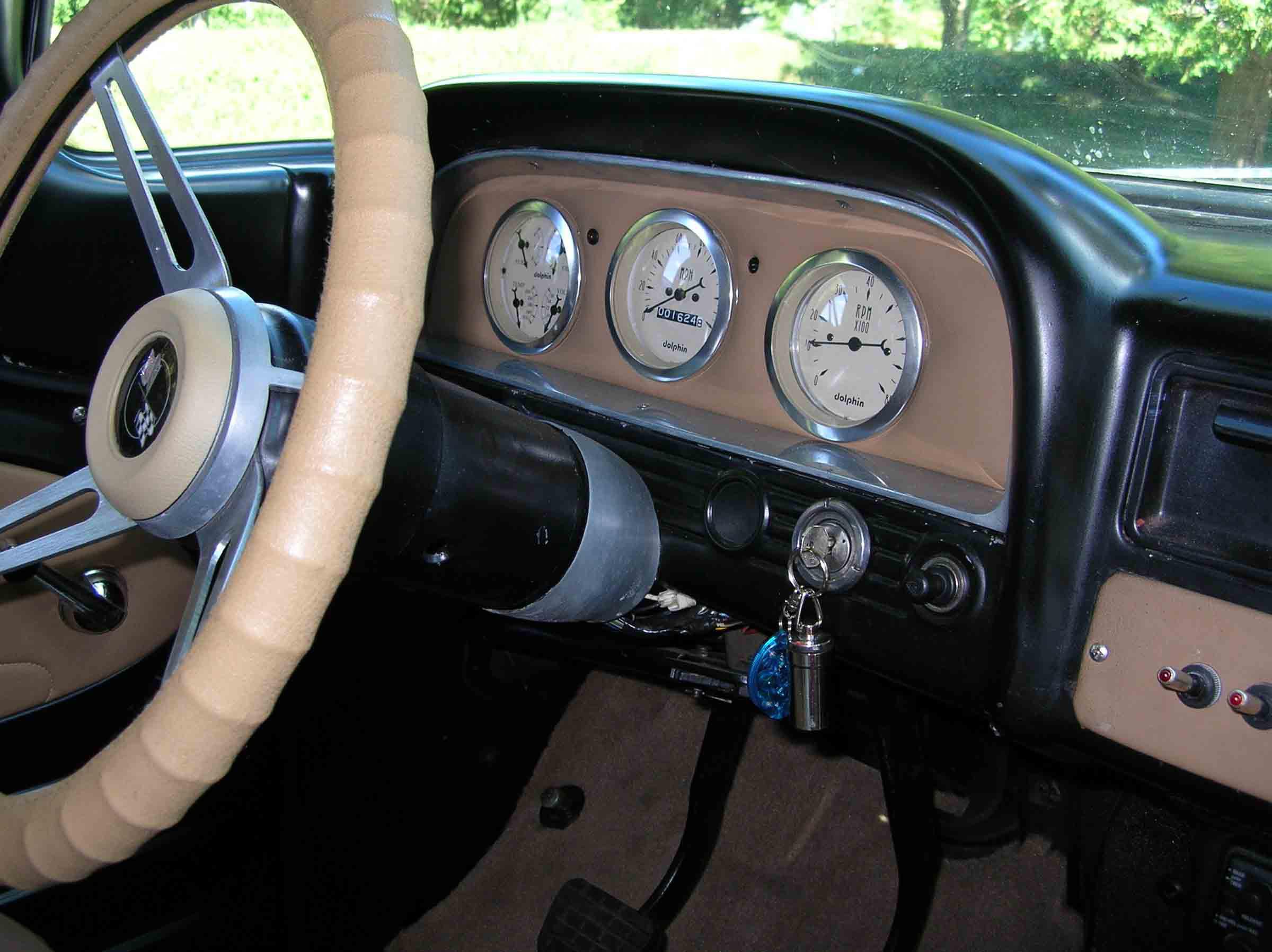

- Dolphin gauges

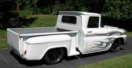

- Body: two coats GM white
and two coats crystal blue pearl; two coats clear coat
- Flames and pin striping by local artist

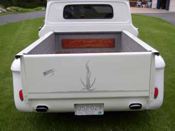

- Oak bed with stainless strips
- 1939 Ford taillights LED

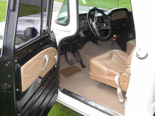

- Interior leather buckets from a Ford astro van
- Rear door panels beige Naugahyde with flame stitch

- Bunch of chrome plating done under hood

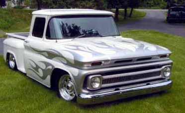

I haven't named the truck yet, maybe someone will come up with a idea. I purchased my truck about four years ago. It was an Arizona work truck at one time (for a Copper
company). When I got it, it was orange on the box and blue on the cab.
Picture from the front ... picture from the back.

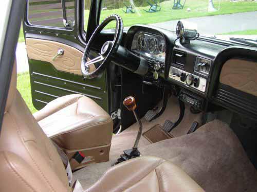

Improvements since then include:
- Warmed up the old 350. It already had the Muncie 4 speed.
- Air bagged it on all 4 and Notched the frame.
- Covered up the hole in the bed where the differential came thru -- with a new oak bed.
- Smoothed the tailgate and installed a roll pan with '39 Ford led taillights.
- The exhaust is thru Flomasters and then out the roll pan.
- The aluminum gas tank was relocated in the rear.
- The truck is painted standard Chev classic white
with two coats of blue pearl and two coats clear over it. Then flamed by a local sign painter, a friend of mine. He is very talented.
- Vette steering gear, wheel, and tilt.
- Sway bars (front and back), weld wheels, nitto tires completed the truck.
- A '74 front end has been grafted on from the back of the driver's door forward.
- Stock rear with a 3 inch notch
- Fan and battery removed from under the hood cleans things up a bit. The aluminum radiator and w/p make it look cleaner
I have been working on the interior with new carpet and bucket seats from a F**d. It is "never done" according to my wife.
