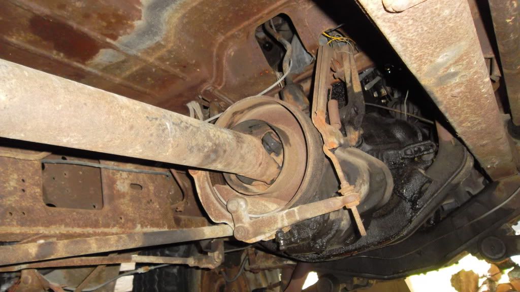

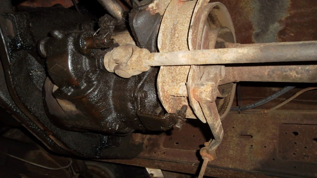

Has anyone installed a drive shaft park brake on there big bolt? Or has anyone even seen one. I have the complete unit in parts, but don't have a clue how it mounts.

What truck do you have? I have two big bolts, both with drive shaft parking brakes - a '60 LCF 60 and a '68 TE 50. I have not had to do anything to either of them, but I could take photos if they would help, depending on your truck model.

I have a 49 6400 2 ton. The out fit I bought it from may have sold me a pig in the poke. I have never seen one a pre 60 big bolt. A pic or two would be great! Thanks.

Here are some photos of my 1960 LCF 60 with four-speed transmission:
Photo from Rear
Photo from Right
Photo from Left

Thanks guys, just what I needed.
