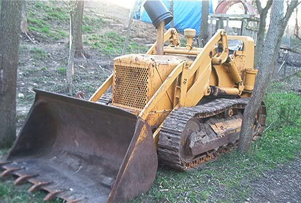

Posts: 3,068
Posts: 3,068
REAL tractors are yellow!!
